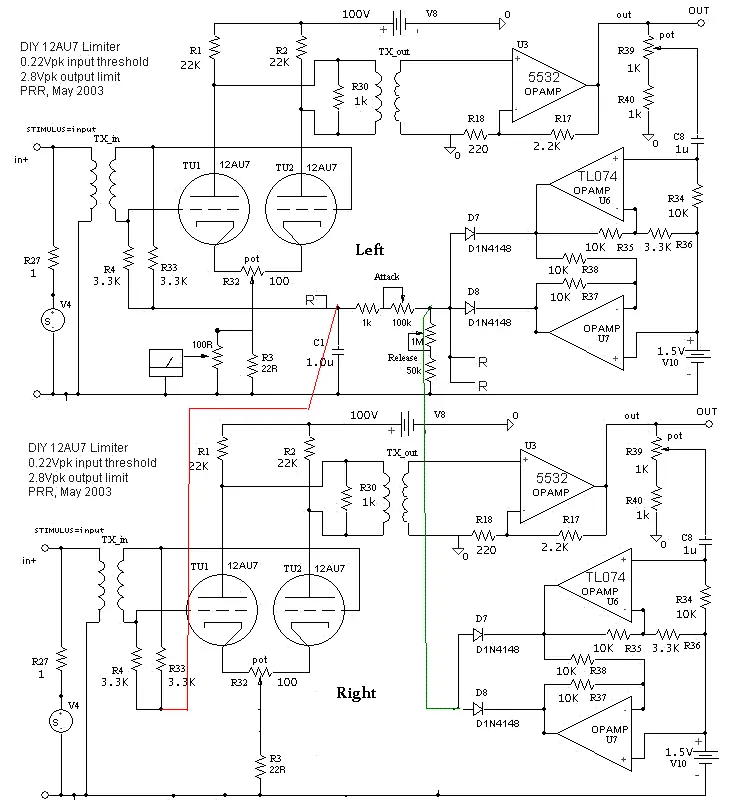

Actually, 600:600 Edcor, and 15K:600 on the output seems better. Having trouble deciphering hte layout for stereo, if I'm reading things correctly this is how it should look: any insight appreciated:
