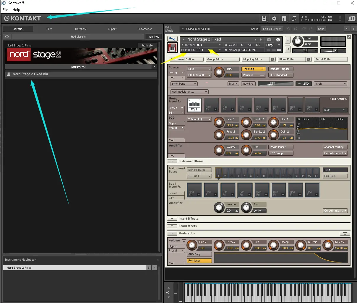

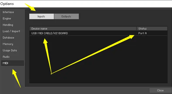

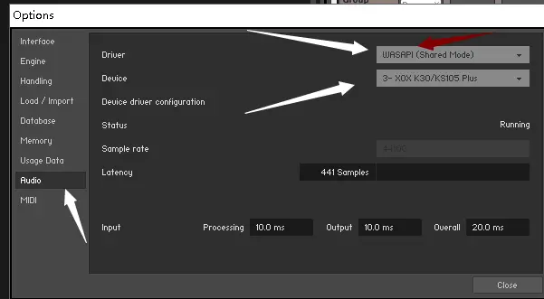

I am using the device:Win10 64-bit enterprise#Sound card: XOX K30 (virtual ASIO sound card)#MIDI keyboard: ordinary digital electric piano
I encountered the problem:I use the mouse to click on the virtual keyboard inside the Kontakt 5 with sound, but I use an external MIDI keyboard without sound
The following is my screenshot please refer to:
Seems to me, you need the same input showing in Sound Module ? Don't know what setup screens are being shown ?
If MIDI is working, there will be a visual on the kontack screen ?

I mention in #3, there should be a visual in MIDI Sound Modules to indicate MIDI signal. Here the MIDI light does not blink.
I have other USB plugged in and I unplug them and start software again. Now my MIDI works and I get sound.
So, one thing to try. Sometimes, USB MIDI just shows up as USB Audio DEVICE and is not specific.
I look at your screen shot and I do not see MIDI light

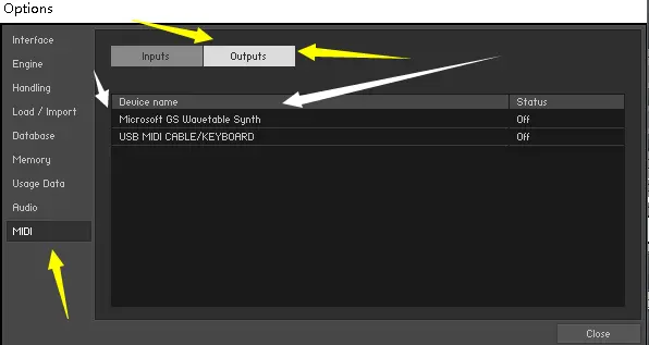

There is YouTube video on setting up MIDI i/o for Kontakt (and MIDI activity is indeed indicated on the Kontakt GUI)---and don't forget to set up your output channels.
Check you outputs in the output frame (looks like mixer faders) by clicking on the frame/display icon (third icon on the very top bar of the Kontakt GUI, to the right of the settings [gear] icon) and selecting "Output." then, right-click on your output channel strip to display a menu with your output options.
