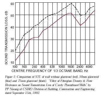

check out the attached chart - it gives the advantage of extra insulation in a wall.
cheers
JOhn

Thanks John. That confirmed what I was thinking. I assume that small bump at about 200Hz was due to either the reduced "airspace" caused by thicker insulation or the insulation itself acting as a conduit (in some small way).
