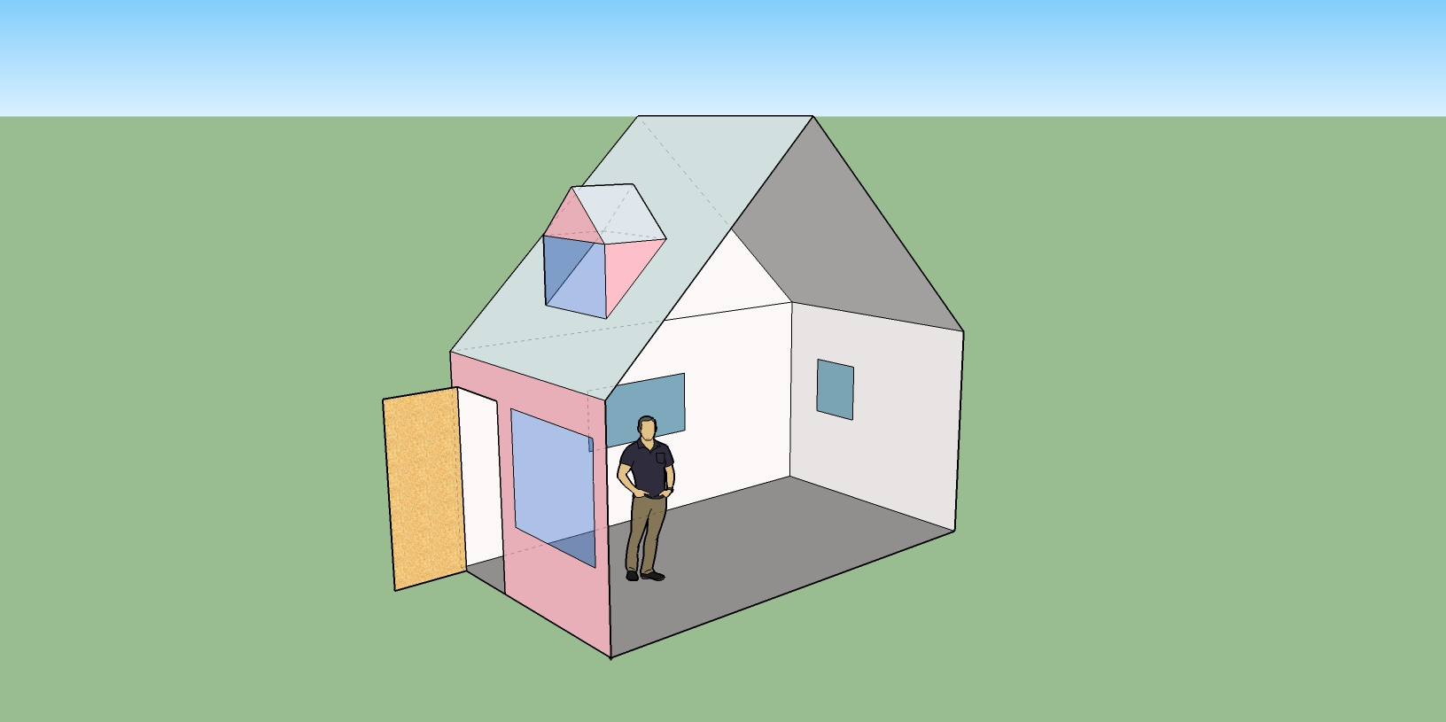

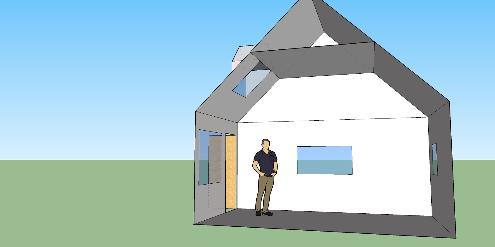

EDIT: Here's a quick sketchup of the space. Garage room is on the open side. Ceiling is currently sheetrocked where a normal ceiling would be (with loft storage above), but I'd like to open it to the roof for better reflections, heat movement and sound while singing acoustically/practicing.

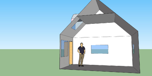

I could create a ceiling at 3.6m/12ft as in the image below:

You're not using this room for mixing, so I would not worry about nodes.

The height is up for debate really! I thought it'd be helpful to open it up beyond the standard 2.4m ceiling that's in there at the moment - to help with reflections and to help the heat rise a little.
Your logic is dead on track. Many times people will expand their ceiling to help the bass leave the room so it is not as hard to treat.
Does it get hard to calculate modes effectively with the gabled / trapezoid shape? I think I'd end up making each sheetrock wall 1/10 out of parallel to assist.
It does a little bit but it is not the deciding factor. Since your room dimensions with a 12 foot ceiling gives you 1771.2 square feet, and the min recommended size is 1500 sf, you should be fine. The line of thinking is simple. If your room dimensions allow you to use it for mixing/mastering, than it will be great for vocals as well and now you know you can expand in the future if you decide to get more involved with your music.
Like I said before, I know how hot it got when I was in Texas and I don't really think that could compare with your location at all. You will need to make the decision if you think having the advantage of adding in the pick fluffy stuff, followed by the pink blow in stuff, will be a benefit to you or not.
