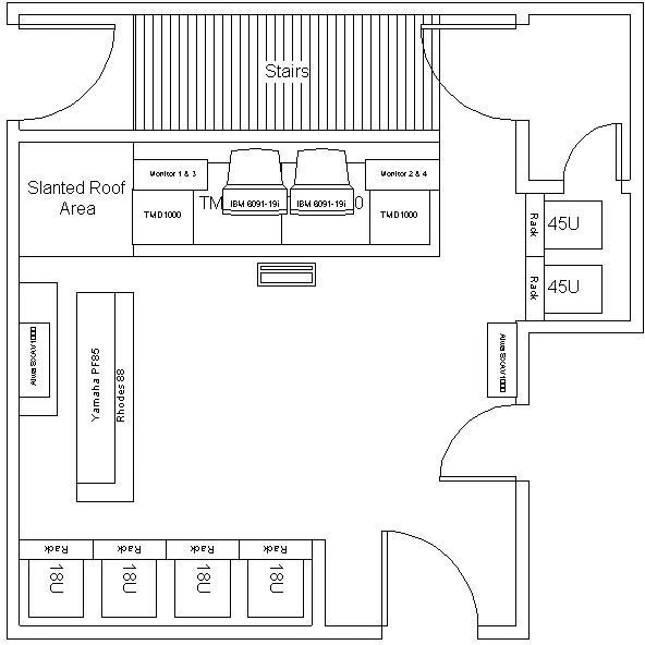

Attached is the overview diagram of my control room. There are two differences between reality and the drawing.
1) the racks across the back wall go completely left to right rather than 1/2 way.
2) the vocal booth collapses against the wall, i.e. hinged to be packed flat. This allows larger equipment brought up the stairs, and around the console table, without getting stuck.
Hope it helps. BTW, the studio is 18'x19', very close to your 20x20.
