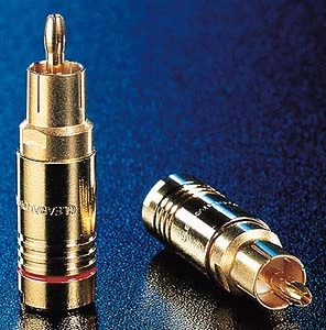

Here's a picture of an RCA connector.

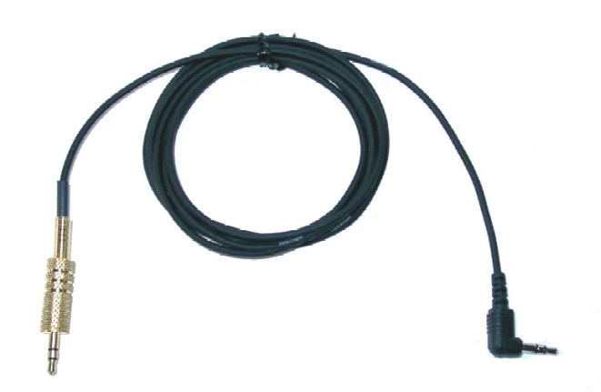

Just to complete the picture (pun intended), here's a photo of a 1/8" miniplug.
