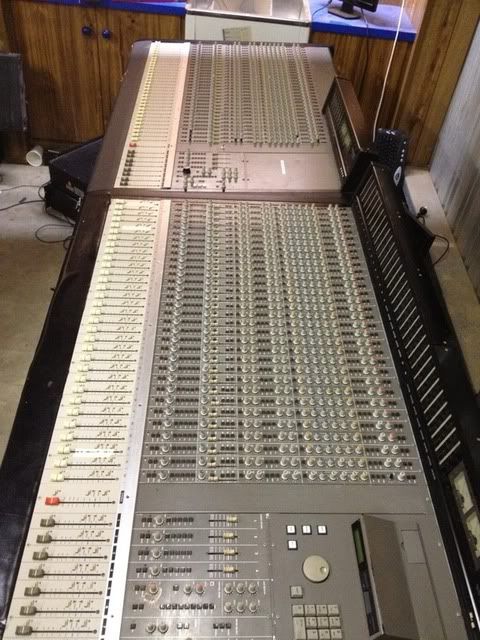

To kick things off, I've just acquired a Tascam M3500 and a Tascam M3700. I was having fun today using the M3700 as a MIDI controller with Reaper. It's nice to mix ITB with real faders :D. Can't wait to have a crack a mixing OTB. I picked up the pair for $500 +$50 for three LA3500 balancing kits and all manuals (including the manual for the LA3500 :cool:).
My plan is to use the 3500 as parts to ensure the 3700 is fully functional. At present all but two channels are working on the 3700 and the faders don't feel as smooth as the ones on the 3500 although this could be because of the automation. I can't wait to crack it open and have a look inside. I'll be upgrading all the OPamps, rebuilding the PSU, re-capping and star grounding it to reduce the noise floor.

Received a shipment of OPA2604 and OP275 chips this week. Still waiting on OPA2132 and NE5532. Already pulled out 8 channel strips, can't wait to get busy!!!
Just a quick update, 8 channels and the master section are all now re-chipped and re-capped. There is no way I'm re-capping the rest of the channels. I'm about to start re-chipping the remaining channels. There's definitely a massive difference between the stick channels and the re-done ones. Just have to buy a few more snakes so I can run all 32 ins and outs from my computer to the console and be able to mix OTB if I want to :). Not sure if I mentioned it earlier in this thread but I also got the console working as a MIDI controller.
Midi controller?? Outstanding. I too have an M3700 and Reaper. Can you tell me how you connected the 3700 Midi capability with your Daw? What are you using for an Interface? I'm using an Maudio 1010lt. So, exactly what does the faders control in Reaper? Are there other features in Reaper that can be controlled by the 3700? You are only the second person I've come across that has done this. I'm just on the verge of wiring my system up and I'm just blown away that this can be done.

Hey mate, it does take a bit of doing and it's hard for me to explain (also I'll need to refresh my memory :cool:). I'll be heading out to my studio this week to take some photos with my new camera so I'll make a little video on how to do it while I'm there.
At the time I too was using a Delta 1010LT but now I have four Terratec Mic-8 interfaces (32 balanced ins and outs total) so I can mix fully OTB. The only MIDI controllers on the M3700 are the faders (all long faders, not the small ones) and the mute buttons (not the actual mute buttons, the MIDI ones down the bottom). I've created a template in Reaper with 32 channels and linked them to the faders on the 3700. At first I linked the mute buttons to the arm/disarm feature in Reaper but it's much more useful for mixing having them linked to mute.
