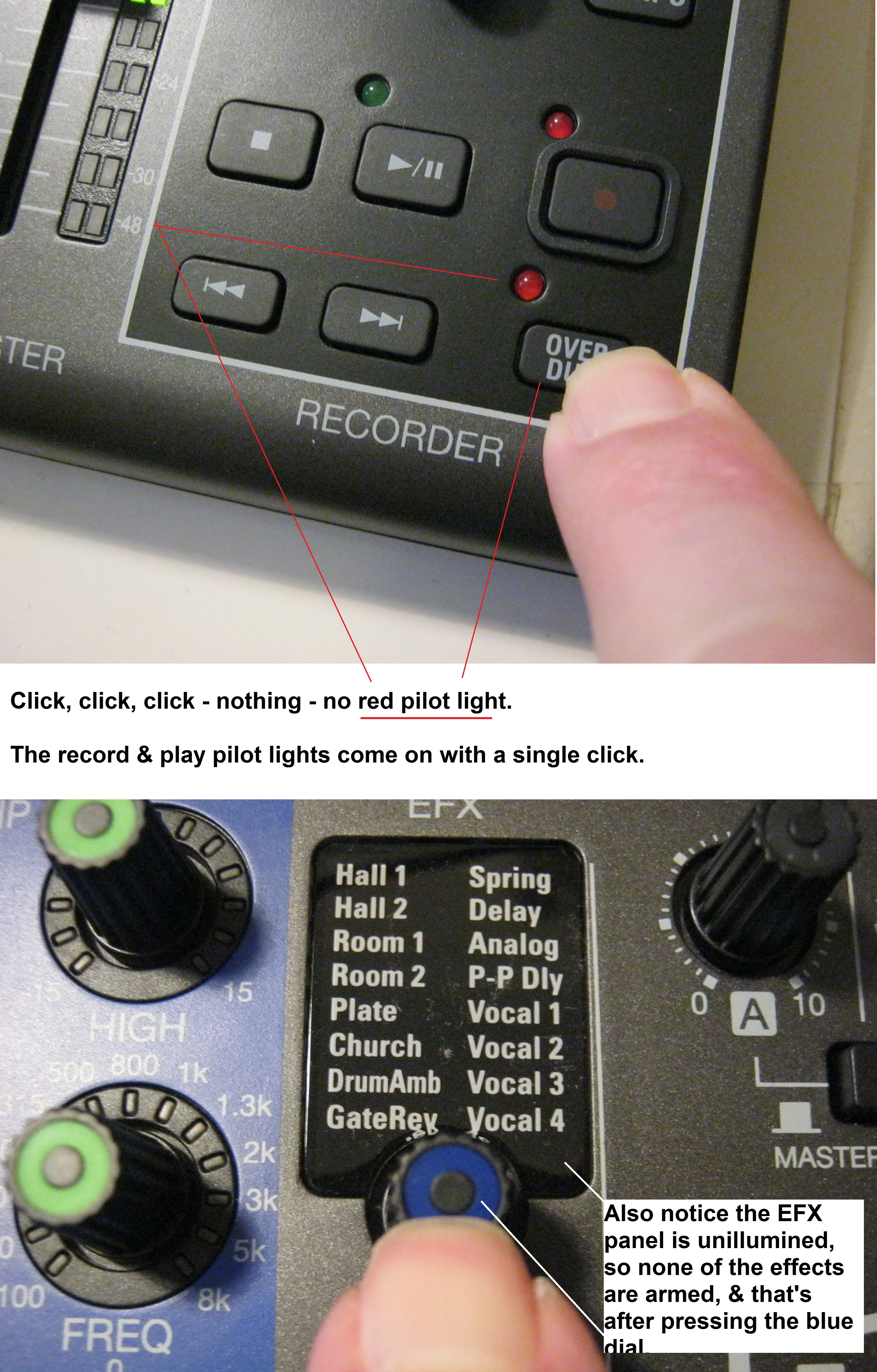

Hi,
Have the Zoom L-12 'Livetrack' digital recorder.
I can record well on one channel.
The overdub button will not illuminate - so I can't overdub.
Any advice please?
Thanks :)
Sorted - there are three recording resolution values, only two of them allow EFX and overdub - that is very poorly presented in the manual. Sorted.
