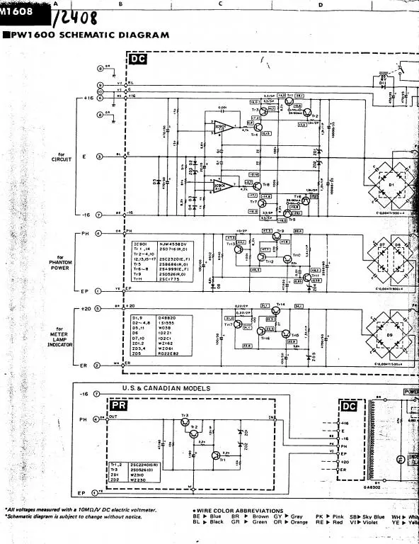

I fairly quickly found a schematic for the PSU and you can just about make out the pin numbers, more searching could do better.
I doubt you will find the connectors so you might have to get creative with a 15way D sub (handy if there are redundant pins and you can use a 9pin?). You might find a suitable round connector?
N very B...do not, FFS short any of those supplies! The regulator circuits are complex DC coupled, discrete HELL! I doubt you could fix a blow up.
Other than that there just seems to be the usual swaddling? Juice for chips, juice for spooks, lamp power.
