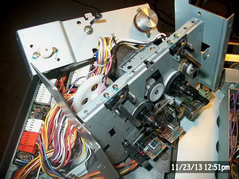

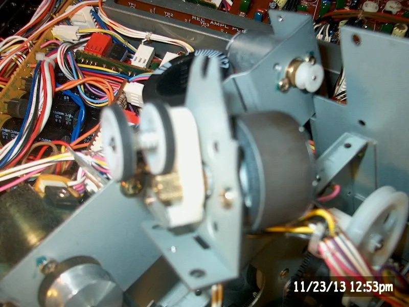

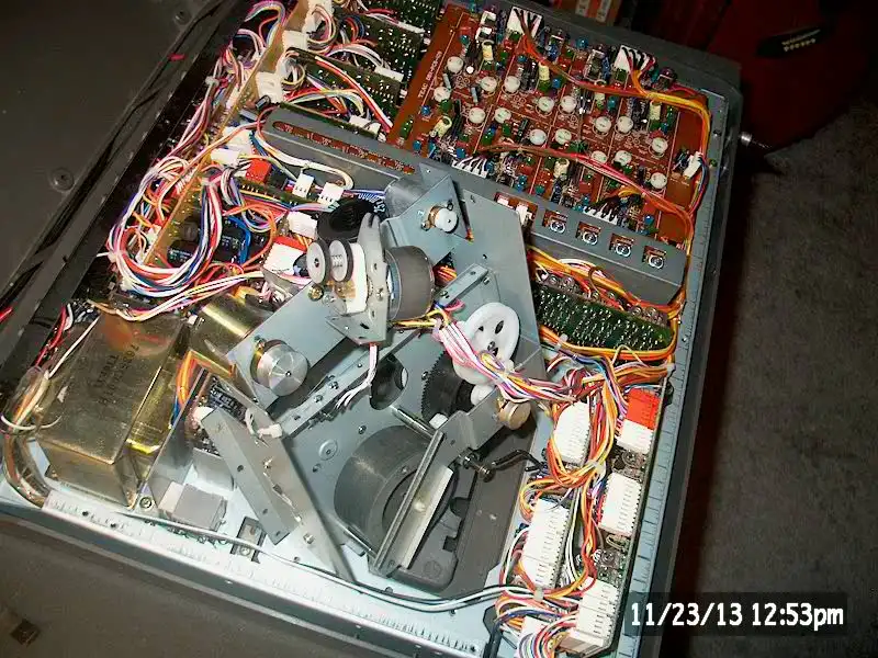

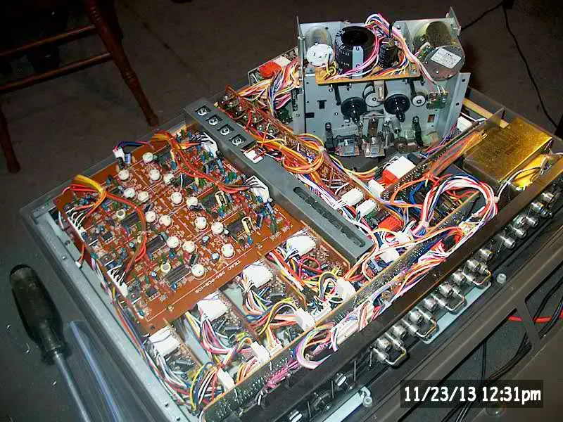

[244 pics below]...

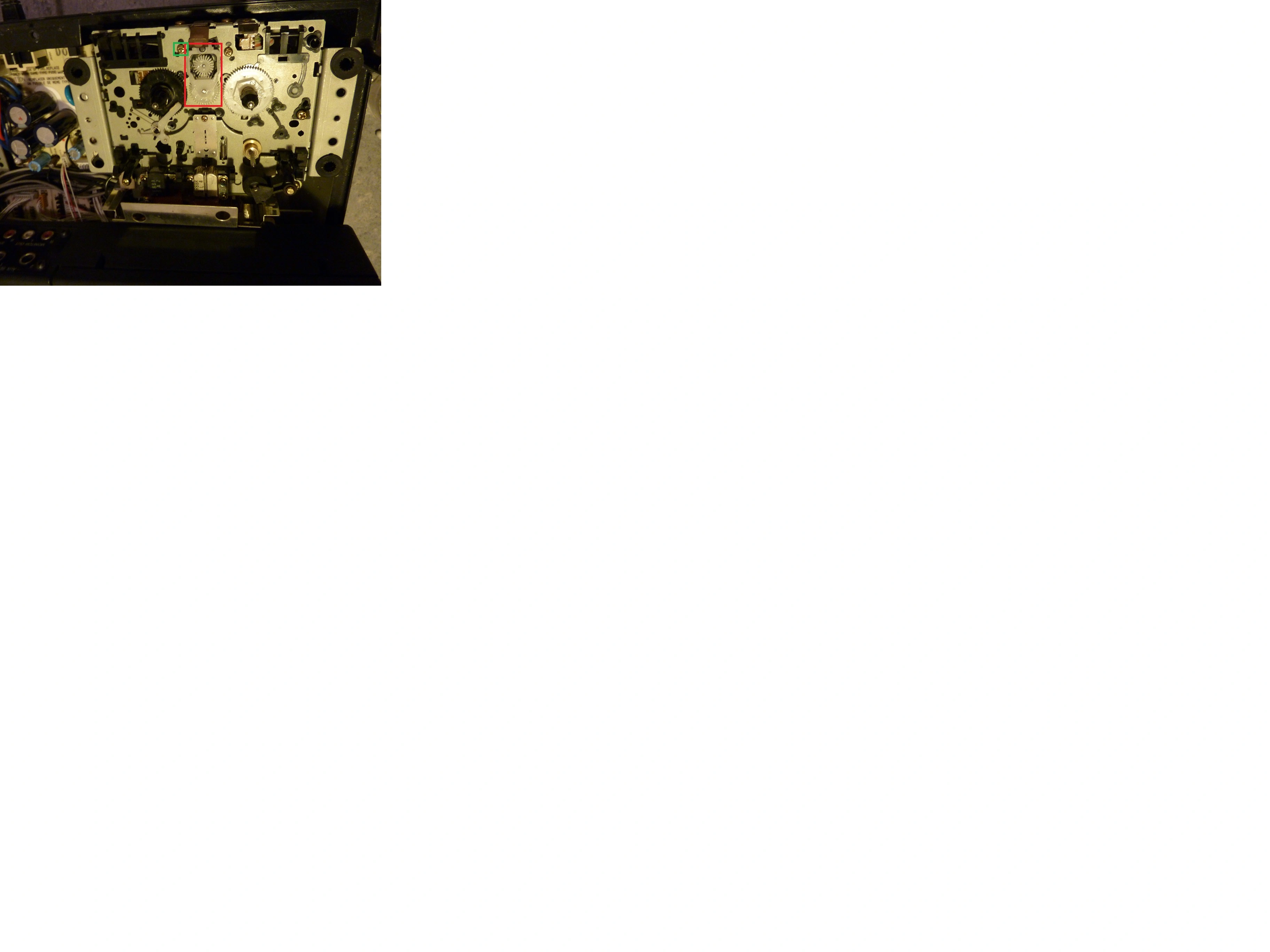

It seems I managed to fix the problem! As per your suggestions I completely opened the machine and checked all the rubber parts. They seemed to be fine, so I cleaned all the components I had access to. After this, the sprockets still didn't seem to be turning the way the should be and I realized the problem was with the switching sprocket which distributes the turning power (in the red rectangle in the picture), it seemed to be unable to move from one sprocket to the other sometimes. After messing around for a while, I randomly loosened the screw to the top left of it (in the green rectangle) and it was able to move again! Apparently, it had become too tight for the small sprocket to switch from one side to the other.
I really appreciate all the help and suggestions you guys provided, and I promise to name my first-born (song) after you guys!

Your post might benefit from a bigger blow up of the photo, but after DL the photo and zooming in, it looks like the more modern MT8X has the clutch assembly mating to the motor with a rubber tire & on the top side driving the L/R spindles with a gear.
If the rubber components are good, that's the best news. The part that swings back & forth is the "clutch". You're lucky you didn't shear off those teeth on the gear with this malfunction, which would be worst case.
I'm glad it was easy and not too serious. If loosening the mounting screw helped, it might be a good idea to apply a very tiny drop of light machine oil, but if what you did works, that's best overall!
