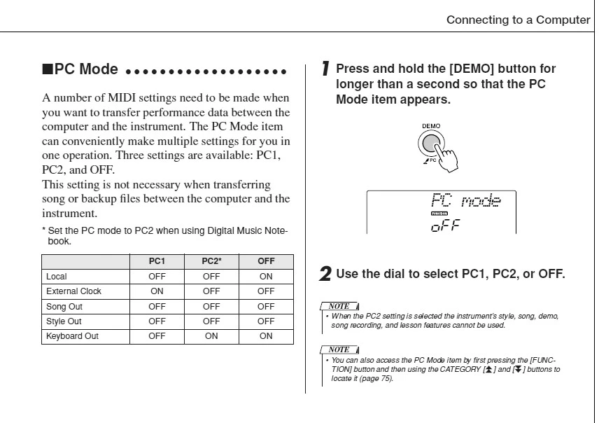

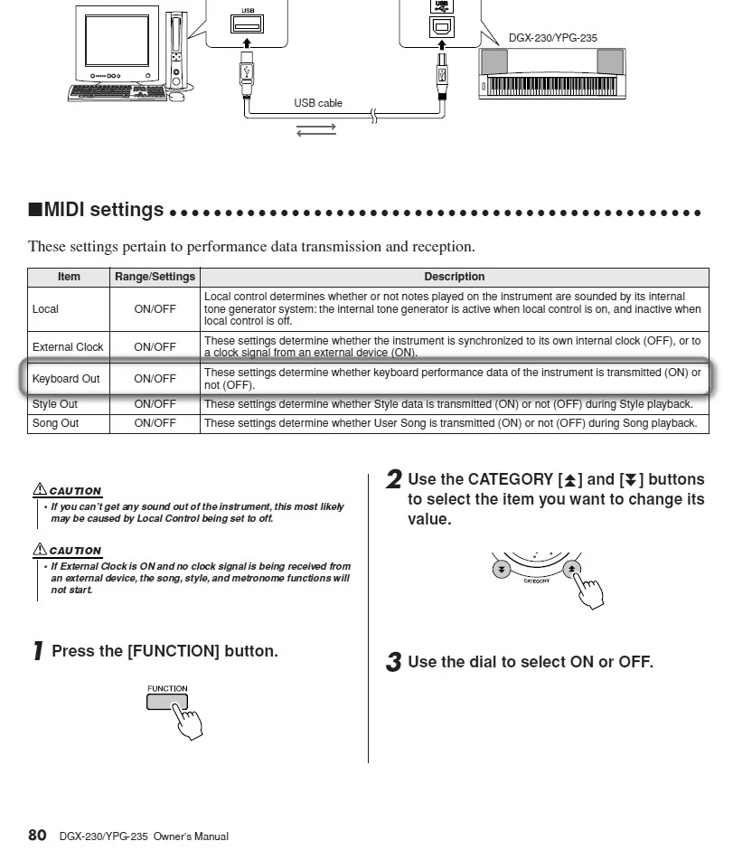

If you haven't yet looked, there may be some settings in the keyboard that affect how MIDI is sent out. Pages 80 and 81 screenshots below.
It appears there are drivers that are compatible up to Win10 both 32 bit and 64 bit if that's what you're using. I just tried installing the driver on a Win7 64 bit PC and the keyboard evidently needs to be connected during the install.
