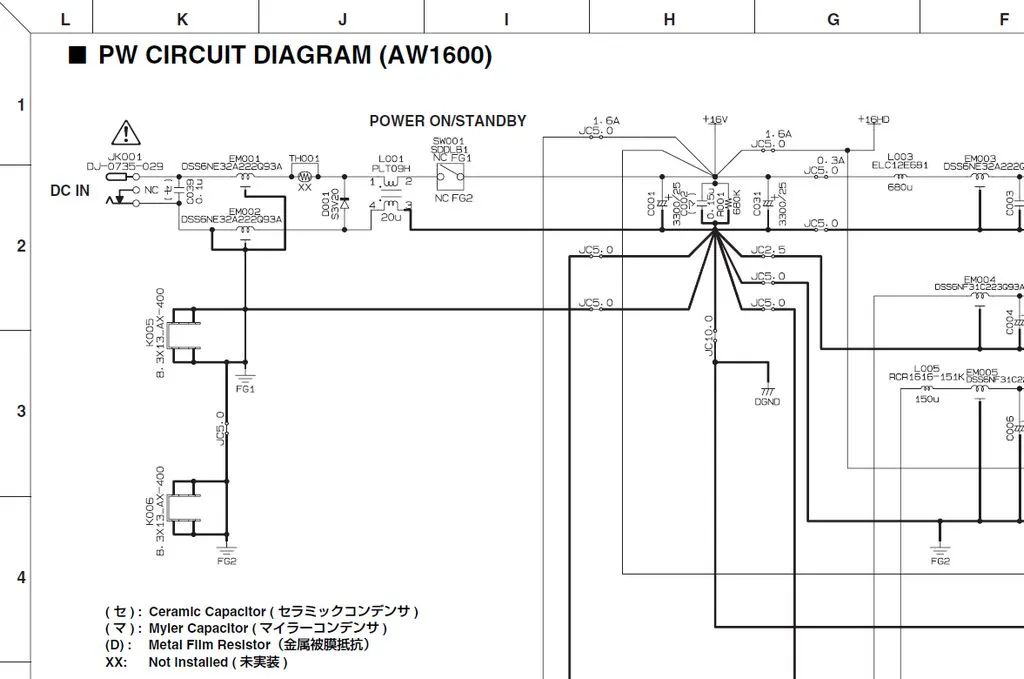

No fuses internal to the AW1600. Likely a pigtail fuse soldered in the PA-300, but the cases on those aren't exactly easy to open sometimes.
dave thanks for your input, I hope to get this figured out - I did not know the power unit had a fuse, I am so lost with all this electrical stuff but I soldier on. Dany
