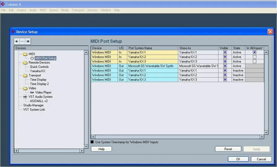

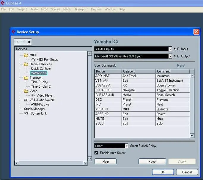

Alright - screenshots attached. These are from CB4. I don't know why, but when I hooked up the KX25 this time it made me reinstall the midi-usb driver and then restart my laptop. I hope I don't have to do that every time.
These menus look set to me. I am thinking the problem lies in the utility menu on the KX itsself under "progchgmode". I prob have to change that from PC+Remote to just Remote.

got to put the kids to bed but ill look at the manual tonight, everything looks as it should though..
Couple of things:
Did you install the KX editor?
Did you use the SELECT buttons to call up “DAW
Select.” and select whichever version of Cubase you are using?
In the second window (device setup) make sure the in and out ports are set to KX1.
let me know if any of that helps..

Setting the ports to KX1 is helpful. I'll make that change. Thanks for the thoughts.

AI is only available under C4 so I would interpret that as CB being the full cubase and CB AI would be C4-AI. definitely poke around the editor and look at what is assigned to what
