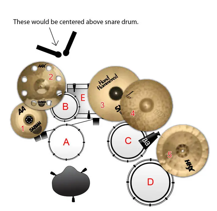

When I have mic'ed my drums in the past, I have always used close-mic'ing on each drum and 2 overheads in X-Y pattern. What I have typically done in the past, was place the overheads in X-Y smack dab over the center of my kit. Not over the snare. The snare is more to the player's left side of the kit, especially if he/she doesn't have a bunch of stuff going on over there like more cymbals and toms On the left side of the hats. I DO however have a bunch of stuff on my right side since I play one rack tom and 2 floor toms.
I recently read an article which stated you should have your X-Y mics centered over the snare to avoid either polarity issues or improper stereo imaging, if close-mic'ing the snare and panning it in center (which I plan on doing).
Here's my blunder then...
If the mics are in X-Y pattern centered above my snare, then the left mic would pick up only mostly my hats, snare, left crash and maybe a bit of the rack tom. Then the right mic would be picking up my snare, ride, right crash, china, cowbell, floor tom 1 and floor tom 2. I guess that's okay (since it would be imaged very closely to how the kit is set up).
However, in order to have the mics in X-Y exactly above the snare, I'd have to put the left mic on a VERY steep angle to catch the stuff on the left side (almost pointing straight down). So in order to have the right side mic pick up ALL the other stuff on the right side, imagine how flat of an angle I'd have to point it. Since it would be so far away from the right side sound sources, I'd worry about proximity effect. I am using CAD electret condensers by the way. I'd worry all the right side things would a) be too weak compared to left mic, and b) lack the low end compared to the left mic since the left mic is closer to it's own sound sources. Also, would doing an X-Y pattern that wide even work correctly?
Please see the diagram attached of MY setup and what I'm trying to describe in this thread. Thanks if you can help!

Then I would go for a Spaced overhead micing situation and forget the X/Y.
A spaced pair would be good for you, or some of the other techniques (Glyn Johns, Recorderman). You are correct that an x/y will probably be left side heavy in your case. I'd go with a spaced pair, but I really like the johns method and it has a nice balance but less stereo effect, while the spaced pair can be a much wider stereo.

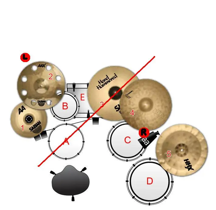

I do my overheads like this. I split the kit in half with an imaginary line from the center of the snare through the kick beater contact point. that gives me a L and R of the kit with the kick and snare centered. Then put the overheads in relation to that line, equidistant from the snare. usually about 3-4 feet out from the center of the snare, pointed down. (pic not to scale, obviously)
That's awesome, Greg! Very simple concept and not sure why I didn't think of this. I'll try THIS first and see how it goes! So I guess the only trick to the spaced pair to keep them in phase is having them the same distance from snare?

Yes. If you move shit around enough, you can get the kick and snare damn near perfectly centered in the overhead stereo image, and everything will fall into place. I mainly focus on the snare though. Measure from the center of the snare out to each overhead. It needs to be as close to the same as you can get it.
