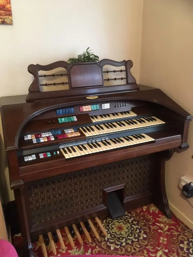

It's funny, whenever I hear or see "Wurlizer" all I can think of is this! The family across the street had one that I THINK their dad would play on occasion. I don't think I've ever seen the electric piano. Around here (in the late 60s/early 70s), it was either a Rhodes or a Hohner Clavinet. I think we payed $200 for a Clavinet C.
It's quite funny to think that this organ was probably more expensive than a 200 in the '60s, and now you can hardly give them away. I've always thought the 200A was an awesome little design. Wonderful, gutsy little sound. When I play my friend's Wurly I can't even describe how it makes me feel. It's almost as if the sound coming out of the speakers is just impossible, like it's coming from a different universe. The sound comes out so produced and processed that it's not hard to become Ray charles for the moment. The soul, the interaction between the keys and the tone/dynamic coming out of the speakers surely can't be replicated. It's not weighted action, and it's not light...it just feels wonderful. As I sit and play it I become bothered that keyboard manufacturers would mess with absolute perfection. I asked the owner Joe "why don't they make this anymore?!?!?" I mean I get it, everything boils down to money these days because that's all that seems to matter anymore in life....but the thing is so small and diminutive, what's the dang problem? It can't be that hard to manufacture this thing for a cheap price. Why bother emulating it I say. It already exists! I'm surprised we haven't done away with pianos, acoustic guitars and drums while we're at it. It's so stupid.
