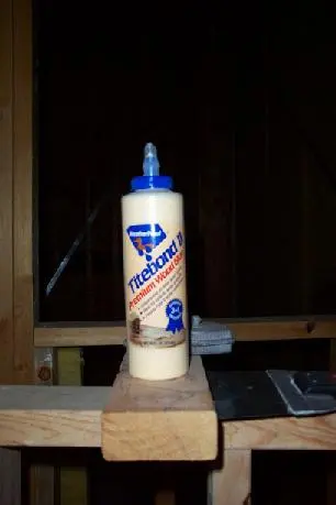

I found some "water-proof" glue. I'm gonna try it.
RICK FITZPATRICK said:
What kind did you end up with Michael?
Ummm... this stuff....??
Cool, thats what I use in the shop. Great stuff. I buy it by the gallon. Forgot the name when I responded. Doggone Alzhiemers.:D Ha! Have fun Michael. Hope it goes easy for you.
