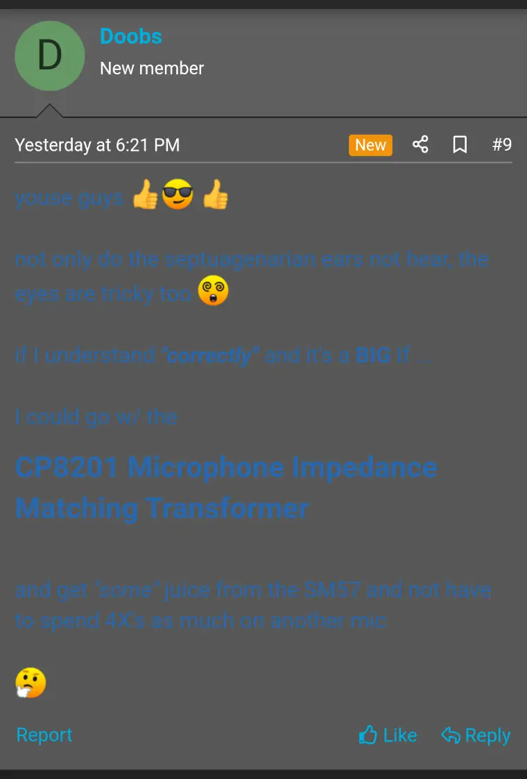

youse guys (y)8-) (y)
not only do the septuagenarian ears not hear, the eyes are tricky too o_O
if I understand "correctly" and it's a BIG If ...
I could go w/ the
CP8201 Microphone Impedance Matching Transformer​
and get "some" juice from the SM57 and not have to spend 4X's as much on another mic
:unsure:
