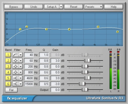

Is this the Ultrafunk EQ in the Sonitus FX pack?(like the pic I attached)
If so, there is an output slider at the bottom. Try pulling that back a few notches and see what happens.
Damn, I don't believe it - that output slider's been there all along, and I've never even noticed it. Duh.
Well, what happens is this: when I cut the output level, it doesn't clip, but the overall level of the track is lower. So, yeah, it looks like the Ultrafunk EQ plug boosts the overall level when I cut the low end. Dumb.
