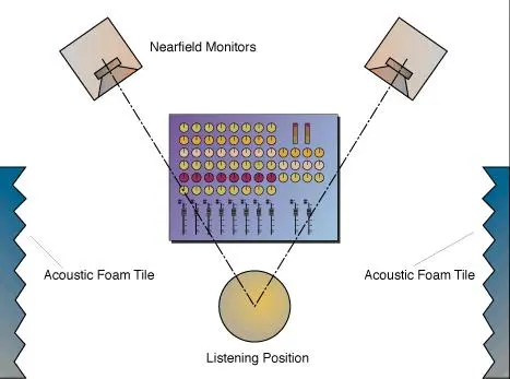

By definition, the near field necessitates at least an approximate equilateral triangle and its associated “sweet spot” for accurate stereo representation.
In the classic near field model the close proximity of each point allows very limited right-left movement from the optimum listening position without skewing the perceived balance.
If the goal is to achieve stereo equilibrium (which is a very pleasing psychoacoustic effect) it’s quite impossible while outside this rather limited center position.
I wouldn’t say you have to glue your shoes to the floor and slip into them each time you mix. :D There is some wiggle room here, and that largely depends on whether the speakers are mounted vertically or horizontally, and the size of the triangle, among other things… But at some point that triangle becomes too large to fall under the near field model anyway.
I may be missing something here, or perhaps we’re talking about two different things.
~Tim
I wouldn’t say you have to glue your shoes to the floor and slip into them each time you mix. There is some wiggle room here, and that largely depends on whether the speakers are mounted vertically or horizontally, and the size of the triangle, among other things… But at some point that triangle becomes too large to fall under the near field model anyway.
Well it is not going to be as accurate if you were to move throughout the room in comparison to the "sweet spot" but you will still have very clean imagery
