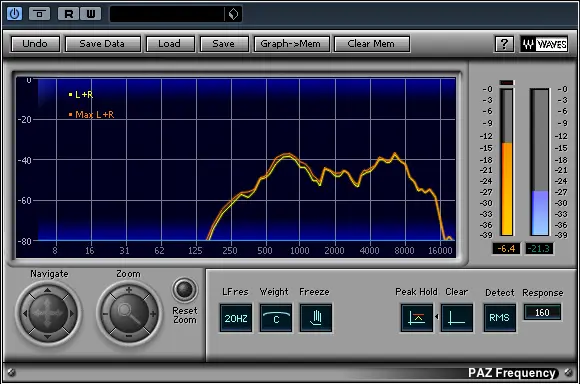

This is the type of response you get with something like an I-phone. Don't expect to hear anything below about 300 Hz. It's down about 20dB by that point. That's 3 octaves above the low note of a bass that is missing, which means throw away the bottom 3 strings of your bass unless you run a lot of distortion.
