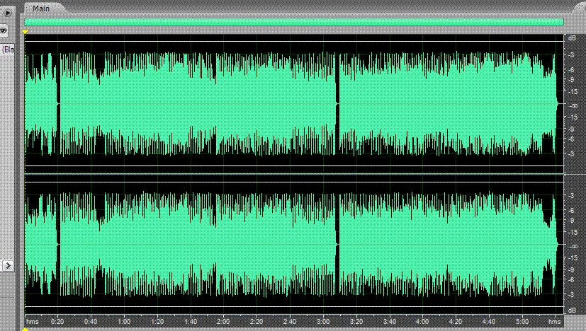

Im not trying to compare sound quality, I know that would be a stupid thing to try and do.
I took a closer look at sad but true off of that same album and found the peak level to be -3db.
I am trying to figure out why my song, while according to the meters is louder than a professional song, its actualy quite lower in audible volume.
Peak levels mean very little to the apparent volume. What's important is the average volume of the mix, also known as the density of the mix, which is measured in decibles RMS, not decibles peak.
Imagine a click that peaks at 0dBFS but only clicks once a second. Not very loud. Now imagine filling in the quite spaces with a 1kHz sine wave at -10dBFS. Now the peaks are no louder, but the overall sound is.
In Audition you can look at the mixdown on the edit screen, pull down the "Analyze" menu, and select "Statistics". I think you'll find that the Metallica pressing has a much higher RMS rating than your homebrew stuff does.
G.
There are options for stereo panning mode in AA 2,0.
If you have chosen “-3db center” then your AA 2,0 is mixing down your session to peaks touching -3db.
Your picture is showing that, I think.
This is probably to make headroom for mastering process.
Hmm do you know where I change that option?
I am new to adobe.

The pan mode is completly unrelated to your situation, NTK.
Re-read Masteringhouse's post, as that's exactly what you need.
Normalizing alone won't help you here because the dynamic range between your peaks and your program average is a bit large. Tame the worst of your snare peaks with some compression or with some manual editing to lessen that disparity. Then try running that result through a limiter, pushing the volume(gain) only to where the tonal quality of the music starts to get kinda crispy sounding, then back off of that a dB or two.
This will give you several more dB in volume. You still may mot make it to Metallica volume, but that would be because the talent and gear on both sides of the glass on that album were beyond what you have available to you. You can't expect a pro result without pro technique and pro gear.
But you can get close, and the above steps are a good start.
And don't worry so much about volume anyway. If the song is good and the performance is good, people will no even care about the volume. Inf the song and/or the performance is so-so, then volume isn't going to make it any better. :)
