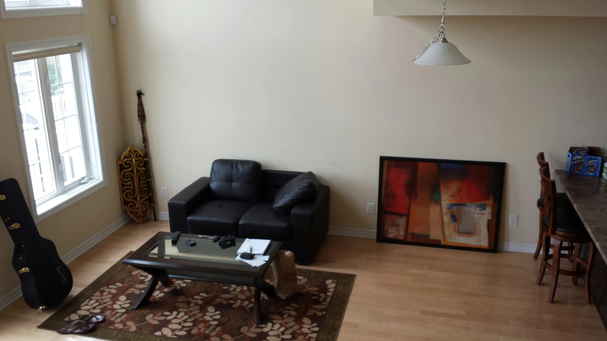

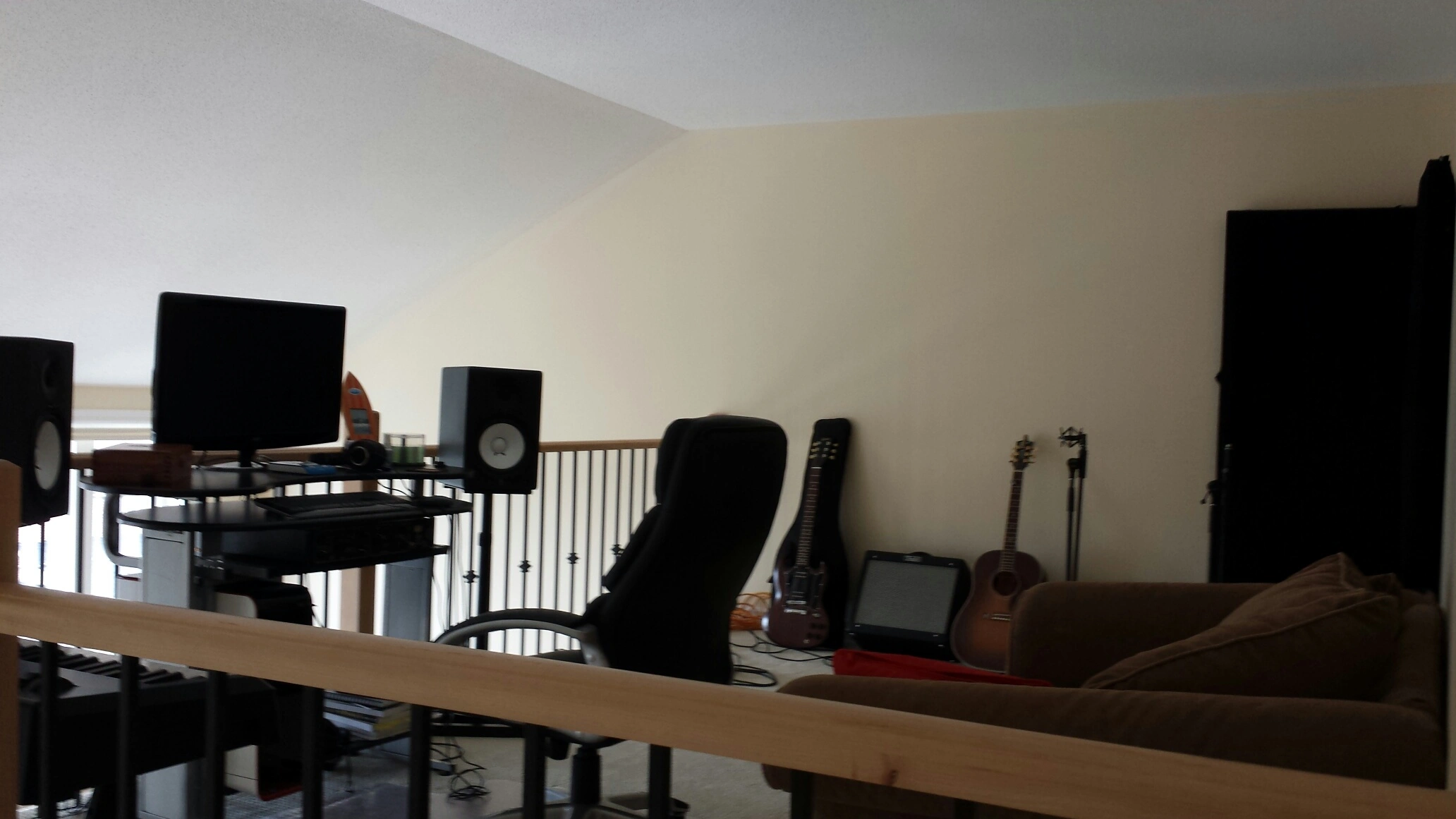

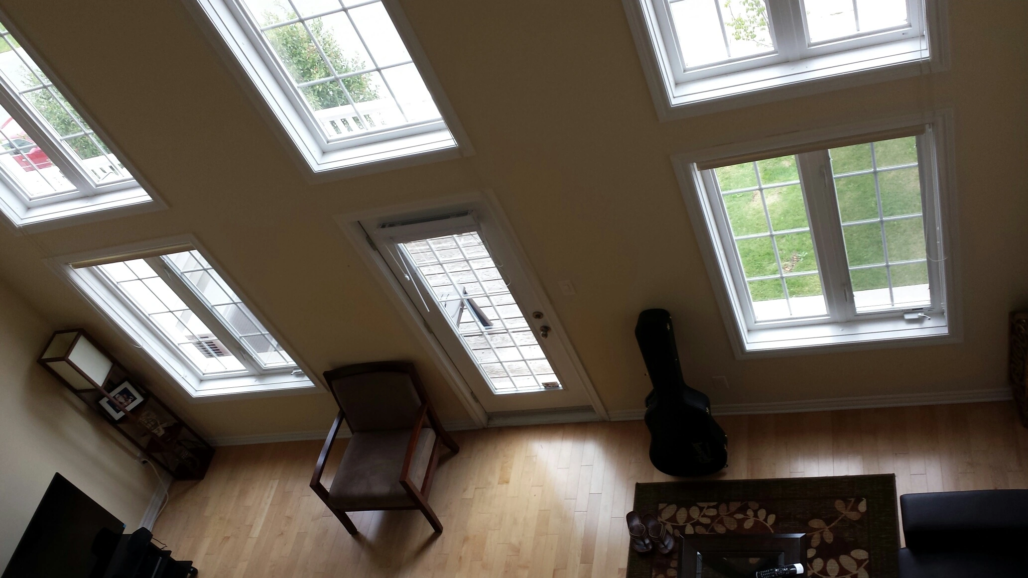

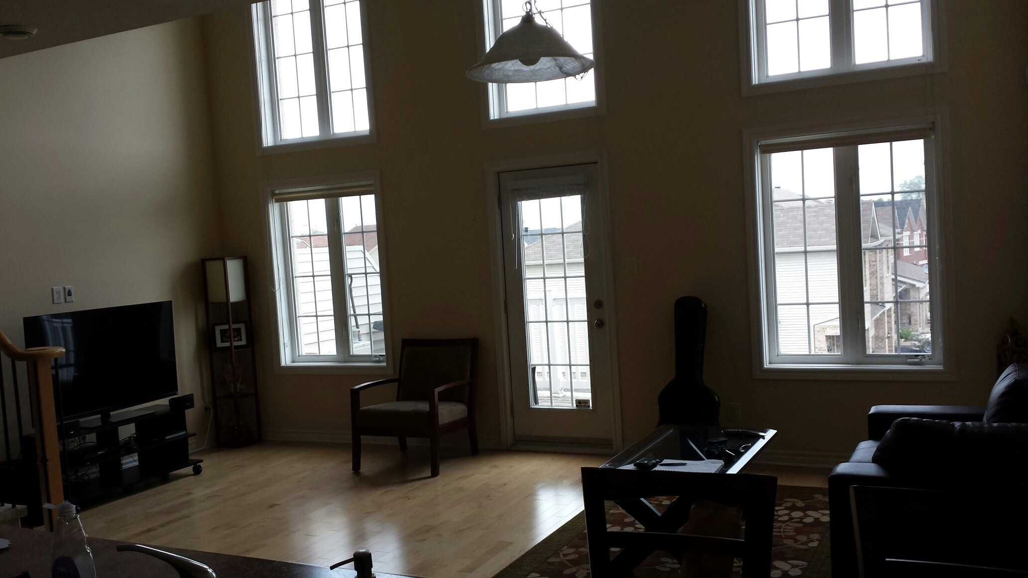

Thanks guys, thought some pics might help for more feedback.

So basically, I'm f$cked. In either space the natural reverb sounds amazing while tracking thru headphones but come mix time the monitors create so much reverb that everything sounds so far away. I do NOT want to treat the entire space as its too huge and would likely be very costly to treat including the cost of an acoustic engineer. What are your opinions if I build a bunch of huge portable traps to bunker in my listening position? I.e, 2' wide by 8' tall? I know it would take quite a few but I've built others before and can do it again. Let's say I do an area of 6'×6', it would be super dead, do you think this would be appropriate for mixing?

As soon as I saw the pics, I knew there would be too much reverb for mixing! I'd say building a 'wall' of traps woudl be the way to do it, basically isolating the mixing area - don't make it too small, though. Be careful your computer monitor doesn't take a dive off the balcony, too! :eek:

The issue is that I don't want to secure anything to the walls...absorbers, bass traps, etc. So I'm wondering if I built large free standing panels (4" thickness) that would be very close to the sound source (i.e. tightly around my speakers, desk and listening position), would that be suitable or do you think that would be too close and "dead" for mixing?
