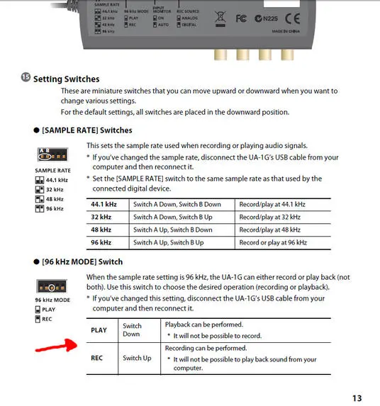

UA-1G not good for full 96K IN/OUT
Hi I just bought this product a week ago for my Guitar inputs. It does almost everything it says except lacks in the 96K mode, which is WHY I bought it in the first place.
This is a strange product. It will NOT do 96K IN & OUT simultaneously! You can Record but you CANNOT Play. Or you can Play but you CANNOT Record. You can do one OR the other but you cannot do 96K IN & OUT at the same time, unless you ‘flick’ a manual switch on the unit itself. It says so in Owner's Manual itself and you can Download that from the Cakewalk website. Not being able to Record & Play at the same time means you must stop and start your sequencer all the time, very tedious and stupid.
I would NOT recommend this product if you need the full 96K IN/OUT operation. Instead would recommend M-Audio’s 24/96 PCI card. That card can do everything it says it can do. I havent tried the N.I. GTR interface yet so I cant comment on that.
