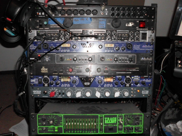

You can still have a rack that looks nice. Here is mine:
That's a nice rack lol ( pun intended) so please give an honest opinion on that interface. Is it clean? Quiet is my main concern. Every interface I've had be it the audiobox or us 200 has just been hissy and full of noise. Or low gain.
It's quite clean actually. 60 db gain on the 10 preamps.
