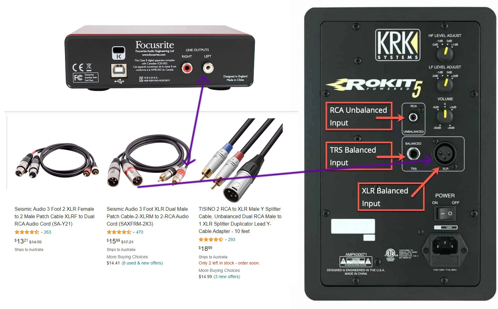

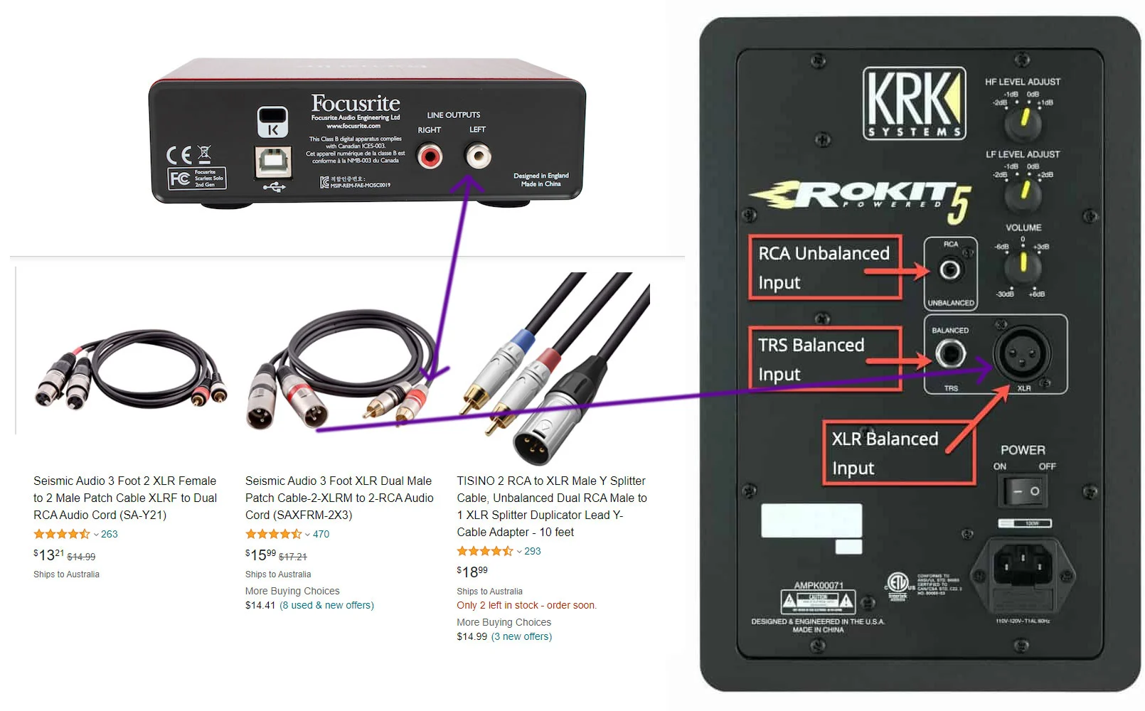

Hello forum.
I'm a newbie with studio gear, and want to connect balanced cables into my focusrite audio interface. My current PC build for some reason is making the Studio monitors make a static and hissing sound, so I saw on YT people recommending to try Balanced cables. The only problem is when I saw my Audio interface it doesn't have the balanced Cable option. So I'm trying to understand what cables I need to go for the balanced option. I have included what gear I have and what I believe is the right cable connection to be confirmed before I purchase them online.
Hope there's a solution, thanks forum.

Not possible. You can’t make an unbalanced signal balanced. The only option you have is to get a better interface. Buuuut, there’s no guarantee that it’ll solve the hiss. I have balanced connections and have hiss on my monitors. It’s just inherent in the monitors as well as noise being introduced from a multitude of factors outside just the cables and connections. A DI box actually really helped reduce the noise, but there’s still some left. I don’t really mind it. It’s very quiet hiss, and doesn’t impact my ability to work in any way.
Thanks for your reply. I was watching some more YT videos on monitor and interface set up. So wouldn't these cables which have the XLR cable (male) connect into the XLR (female) where it indicates its the Balanced section of the Monitor, and the RCA parts of the cables go into the interface? Are these not the right type of cables?
I just bought the interface since I found it on Christmas special, I should have invested to buy a better interface as you specified.
Worse case scenario, I'll try a DI Box and see if the noise goes away.

You certainly can make an unbalanced signal balanced! People do it all the time*. There are several options. Simplest one for the newb is a pair of 1:1 transformers (means a ratio of unity, no step up or down) The Art Cleanbox two is very well thought of but you can buy a very cheap twin transformer unit off Azn which is actually not bad and will break any 'ground' loop if that is your problem and that is quite possible since I see those monitors have a mains earth, 3pole IEC socket. I shall find you a link shortly.
Another method is to 'impedance' balance the outputs but since that involves some soldering and a VERY tiny bit of electronics I shall leave that there as FYI. Even more complex but technically the best solution is *. (if you CAN do some soldering and wire surgery do tell!)
You do NOT want to get a "DI Box". As these things are generally considered, they use a high, 10: 1 transformer to deliver a balanced, mic level signal and even very high quality high ratio transformers can alter a signal audibly.
Yes, you would have been better advised and got a more expensive interface but if swapping it is a problem, hang in there and let us sort the problems? There is no guarantee that a $1000 AI would not cause some form of noise issue. Look upon this all as a learning experience and save up for better. (I cannot recommend the MOTU M4 TOO highly!)
*A few weeks ago I built a high grade electronic balance box to drive my Tannoy 5As but that would be a little beyond most folk. The build is in the DIY section.
That's the chap. Initially just plug it into the AI's RCA outs and the speakers. That will eliminate any ground loop issues. If you find the transformers cause some changes of the sound you will need to buy better but maybe, live with it for now and save pennies? Ifm as is likely, the sound is fine you can then buy or make RCA to XLR balanced cables and have a balanced feed to the speakers.

I wasn’t recommending the DI box to you. That was just my set up as I need to use its ground lift function, which is probably not applicable to you.
At line level - I really doubt you'd hear any difference between balanced and unbalanced connections and loads of people work on an RCA output to their speakers. Hiss? You mean a constant unchanging hiss, but crackles? As in a loud nasty broken cable type crackle, or a more electronic crackly sound? or a buzzy crackle? This is often a problem with the driving computer putting noise onto the interface's ground. Disconnect the interface from the computer. Does the hiss and crackle carry on? This indicates the issue is between the interface and your speakers. If removing the computer makes no difference - then you know where to look. Disconnect the link to the speakers and add headphones? Still got hiss and crackles? You need a systematic connect/disconnect each piece to track down the source here. I doubt it's cables.
I agree Rob, I was really answering the OP's original question and countering the point that unbalanced sources cannot be balanced. As I pointed out, they can of course with varying levels of complexity and cost. What is not easy to do is make a Ubal input balanced. You either need good quality "10k 10k bridging" transformers or some electronics.
I tend to suggest peeps buy that dual transformer unit because it has pretty good performance (at -10dBV levels) low cost and is a very useful 'diagnostic' tool.
