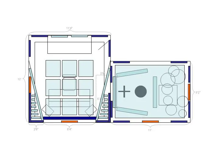

I don't hear too much about them. They seem like a good solution for my room but I'm wondering how effective they are. My plan is to use them in the front two corners and panel traps in the back corners and wall. Anybody have any experience or opinions on them?

There is a window (orange rectangle on the sketch) on the left of the control room that I wanted to disappear so I thought the hanging absorbers would be good for than. I chose panel traps because I wanted to keep some of the mids and highs while eliminating more bass since the hanging bass traps would probably absorb everything. So basically the best way to go is just fabric wrapped RF panels all over the place?

Hookie, I believe the SAE site is exactly where the "bass hanger" concept evolved from. As to verdict, I don't think there is any yet. Even a known acoustician personally disputes it, but yet says there must be something to it or other well known studio designers wouldn't still use it. That is not to say it works or does not work. It only means that TESTS in the context as they are used in studios, have never been performed or published that he knows of. What you would be basing your installation on is "published experience", not proof. Which a lot of homerecording acoustical "net fact" is based on. To truly discover what does and what doesn't really work is through vigorous testing. Although, some recent tests have confirmed that using "superchunks" of either rigid fiberglass or rockwool placed in corners from floor to ceiling REALLY works as a low frequency absorber. Prior to that, it was all "experience" based knowlege. Which amounts to trust in word, not test results.
These tests were conducted by Auralux, at their expense, using various materials and products. I won't get into that, as I would be placing my head directly in the path of the debate giotine as there are certain elements of test result ambiguity there :D As to the use of rigid fiberglass, rockwool or other products as broadband absorption, there is no doubt it works to the extent of absorption coefficients. How much, where placed and the "edge effect" performance is the issues of debate. I still see opposing opinion regarding these issues. So, who knows really.
