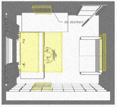

Hey, this is my room:
blue is door,
red is window,
green is segment, (unable to move, erase, or anything)
yellow is couch,
brown is table,
and the last one is my computer with pink monitors.
I use it for recording vocals and e-guitar and mastering.
I have naked concrete walls. One is covered by segment. The most important is i guess wall behind my couch (becouse of monitors). Floor - panels and little carpet (1.3m/1.8m) laying on the center of the room
Have you any idea to treat this room efficiently using DIY methods?
you can put diy absorbers in each corner = wall-floor wall-ceiling if need be = and overhead of the mix position is an absorber called a cloud. on each side is one to reduce side reflections, and on the back wall is one to reduce rear reflections. try to center your desk on the wall. one problem with your space is its almost square... which means room modes are stronger...
lastly, put a heavy drape over the window when you need the front wall to be less live. these steps will help.

It would be of help if you could move toward the center of the room side to side and also move your setup toward the back a bit. Being right next to the wall will cause problems in the bottom end and your listening position should be back farther.
I don't know your budget nor the cost of DIY materials there but this is what I'd do:
1 panel at least 50mm directly behind each audio monitor on the front wall for SBIR.
1 panel at least 50mm thick horizontally between the speakers to help with depth and imaging.
2 panels at least 50mm thick on the side walls at the reflection points.
2 panels at least 100mm thick on the rear wall above the couch centered on the wall left to right.
1 panel at least 100mm thick straddling each of the 4 room corners at a minimum - more is better.

if you follow Bryan's advice on the size and number of rigid-fiberglass-covered-with-cloth type absorbers, you'll be in decent shape. the rigid fiberglass (or mineral wool, rock wool - examples include 703 Corning, Roxul, etc) should be 3lb/cuft (48Kg/cu m) and you should use fireproof (or treated) cloth which allows reasonable air flow (such as burlap, speaker cloth, etc to ensure good bass absorption and minimal high frequency reflections).
That segment (or bookcase) on the left wall really isn't helping anything at all. All it's really doing is stopping you from treating the wall on that side the way it should be treated.
If you can move it out of the room that would be best.
Bryan

OK. After seeing the cabinets (segments), I think a stop and regroup is in order. You're never going to get things sorted out with that on one side of you. Since the room isn't that much narrower than it is long, I think you should turn the mix position to face the right wall of the drawing with the cabinets at your back.
That'll give you some space to play with on the front wall, keep things relatively symmetric, etc.
Bryan
Bryan has a good idea - put the cabinets to your back. either way, i think you need to pull a drape over it because of the reflections and resonances and still the need to access it... maybe some absorbers on stands to trap in front of the cabinets could also do it.
