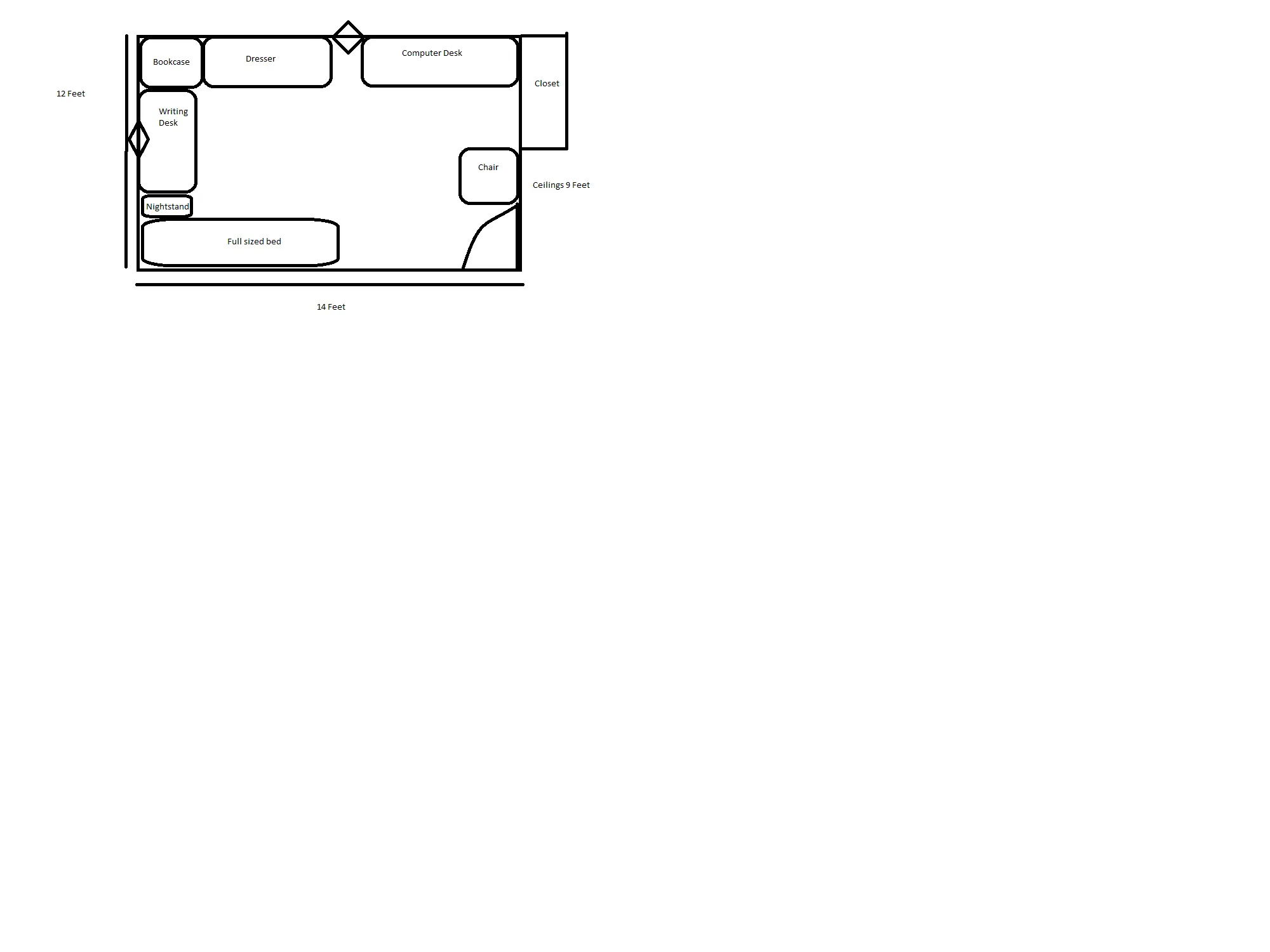

Hi, everyone. By way of introduction my name is Matthew and I'm a bluegrass musician from Oklahoma. I've taught and played professionally for a few years and have recorded two CDs with a professional. I want to set up a small home recording area where I can create backing tracks for myself and generally doodle around. Unfortunately, while I attend university, this will have to be in my bedroom. I understand there are many pitfalls to doing this, and I am well aware of the fact I will probable never get halfway decent sounding recordings.
The recording chain I'm considering is a Focusrite Scarlett 2i2 used with either my desktop or laptop and a mid-range condenser microphone as well as a few dynamics.
I've attached a crude drawing of the room. Please forgive the shoddy artwork. It is 12x14', the floors are carpeted (ouch), the walls are wood paneling, and the ceiling is rough textured sheet rock. It has two windows (shown by diamonds.) and a small closed. Only one corner is exposed, and I'm hoping that will cut down the bass. I can record from either desk. When I do the clap test, I don't hear any unusual or horrible sounds.
What are the main hazards I need to be watching for? I can't really modify the room in any way, but I could add non-permanent things. What tests do you recommend I perform to get a better picture of what kind of stuff I'll need to treat it effectively? I hope all these questions don't sound completely stupid.

Well as a Audio Engineer and Acoustic consultant you have to consider the Standing waves that you will have in the room the bounces of the frequencies above 300HZ . Also you have to run a few test that measures the room in .60 to .85 seconds of Reverb to have a nice treated room.

The measurements are 12x14x9 feet. As far as bass traps and other things go, will having junk in the corners affect things? In other words, I am going to have to move all my furniture away from the corners of the room? Here's the analysis of some guitar chords on a cheap mic. I don't know if that will help anything.

Thanks so much for all the information so far. One more question if you don't mind. Where would be the optimal locations to place these? I know you gave several different dimensions for the traps. Does each one need to go in a specific locations? Thanks.
nope you can put it in any wall but it has to be on the walls . I recommend mostly up to avoid children to touch it or start messing with them.
Man, seriously?
Stick a bass trap in each of your 4 corners and as many others as you can in as many corners (including wall/ floor and wall/ceiling) as possible. Also, take care of your first reflection points.
You don't need all these ridiculous calculations. It's a bedroom. :eek:
I would also put your monitors and work station where your "writing desk" is. You want your speakers along the short wall firing down the length of the room.

Hi,
There are many undesirable issues with your current setup. You should be centered and should stay away from the corners. Is it possible to move your setup over to the area by the writing desk?
You'll want to look into treating the front corners of the room along with the first reflection points, not just absorbers placed randomly throughout the room.
You can use the following as a guide: http://gikacoustics.com/acoustic-advice/
Yes, that's actually where I was messing around today. I found recording sounds best with my laptop on the writing desk, with me facing towards the bed. It seems to cut out some of the muddiness. I actually have access to one other room that is much larger ~20x16 and has a tall, vaulted ceiling, partial hardwood floors, and lots of soft furniture in all the corners. I get no reverb at all when clapping, but I haven't been able to record anything there. The only caveat with that room is absolutely no modifications. Everything must be free-standing.
Two things I forgot to mention. First, the style of music I play doesn't really require much of anything below 100hz. I can pretty much roll off anything under that and not even tell a difference. Secondly, I'm more focused on making it sound good for recording. I like bluegrass totally unaltered when mixing, so I'll just be adjusting the volume mostly. For the first part of my recording I'll be mixing with headphones (I can already hear the groans.)
Just about down to 100 Hz is what you want to aim with for treatment when recording vocals anyhow so that works out well. I would focus on getting a solid monitoring area down with moveable panels at reflection points. You could then use the movable panels when recording (along with a few other in the room too).
