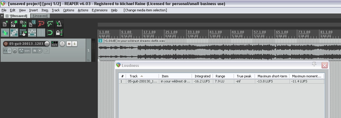

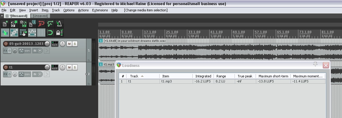

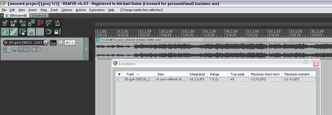

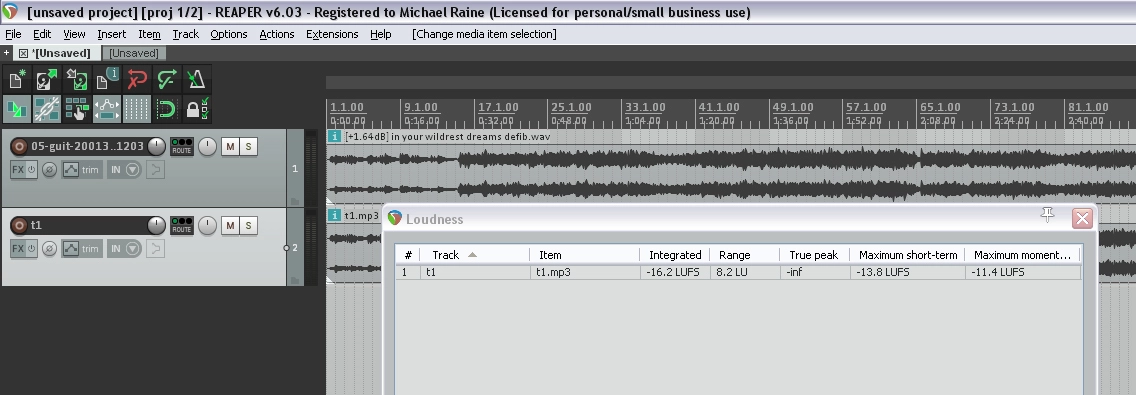

I loaded a random WAV into Reaper and measured its loudness.
I then rendered it as an MP3, and loaded it into Reaper, and measured the rendered files loudness.
They were identical.

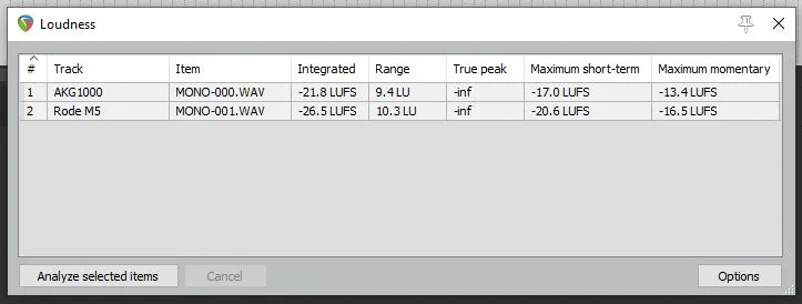

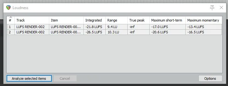

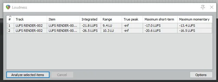

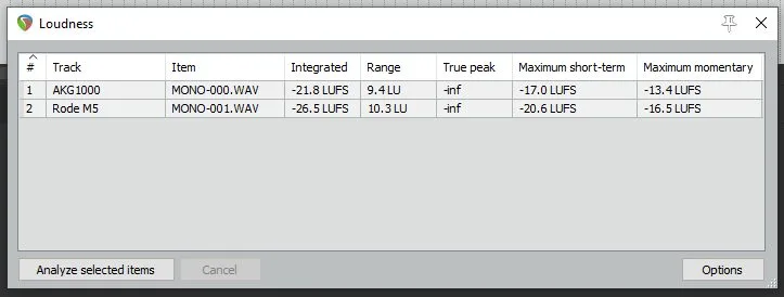

I did the same think as Gecko, and got the same result. Even did a stereo file, with each channel panned 100% left and right, then split the stereo to two mono files. BTW, both files had a maximum peak value of 0.0dB, just to take that out of the equation.
All faders were at 0.0 (track and master) with no plugins at all.
Attached below are the images.
I think I may have finally stumbled on an answer to your question.

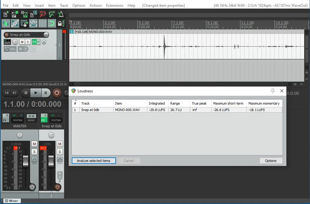

When you render and have a peak reading of say -2.1dB that is maximum of the highest peak in the entire file. It could represent a single half of a wave that reached that maximum level.
LUFS calculations are not based on the maximum peak size. LUFS can be tracked by the momentary value (averaged over 400 ms), and by the short-term value (averaged over 3 seconds), or the integrated loudness is tracked and averaged over the entire length of your program. Meaning that if you are working on a three-minute song or a forty-five minute TV episode, the integrated LUFS is a single value that gives you the sum of loudness for your entire project. That 400 ms averaging (0.4 seconds) will integrate out any maximum peak, if adjacent peaks are lower.
So you could have a track which is basically -50dB silence, with a single snap at 0.0dB. Normalizing it will keep the single snap at 0. However, when you measure the LUFS momentary value, it will average that 0dB peak with .2 seconds of -50dB silence on either side for the momentary value, 3 seconds for the short term, and the integrated will probably be close to the -50dB if the track is long enough.
So, you cannot use the maximum peak size in Reaper's meter to determine the LUFS value. They are two different measurements completely. The Reaper meter is measuring the maximum instantaneous wave value in dBFS, so that you don't start to square off an input (hard clipping). See attached image. I normalize the file, and it actually hit +1.7dB on Reaper's meter. You can see the LUFS analysis is much lower. LUFS is not the same as dBFS!
Does that help?

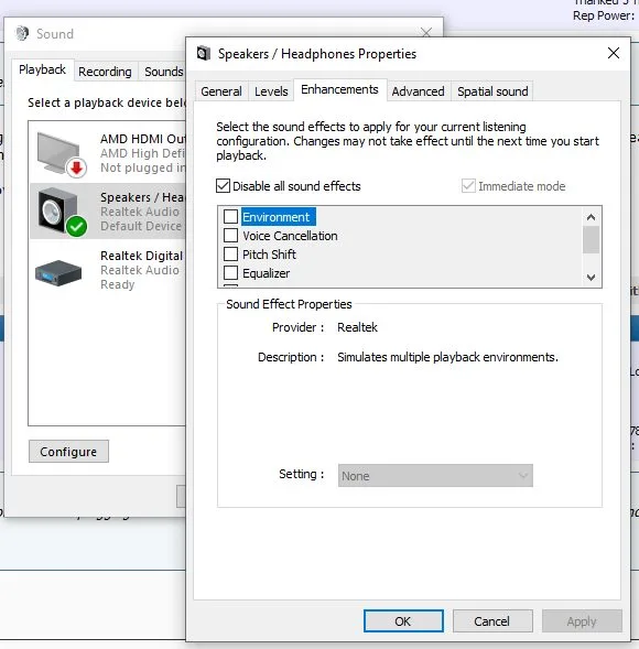

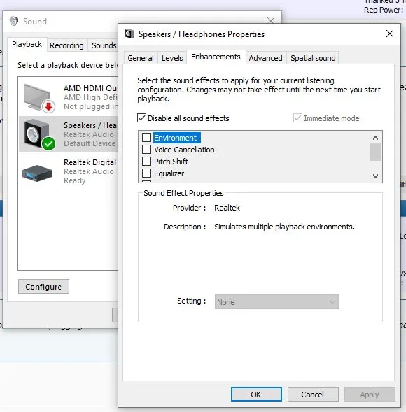

Then I found another BIG one. My Dell has wavMaxx audio upgrade. This has an enhancer in a tray menu. It was selected to not load on start up. I had no idea it was still active in the background. It seems every play back of mp3 was being bass boosted then?So all my audio files are making boomy noises and yall cannot even hear it as I am.
This highlights the importance of having an accurate and reliable monitoring system. While it is really useful to playback material on a variety of systems, it's important to make any mixing decisions and judgements when listening to the principle monitoring system. This would be through your interface, rather than through the computer's internal sound.
The render meter is not in LUfs? Is it RMS or peak dbfs? Where is this indicated anywhere? So the render meter and the main meter are not in the same scale?
Yeah, many computer systems will have "enhancements" under the Windows sound settings. Enhanced stereo, Space, EQ, etc. ALL of those things need to be turned off unless you need them. EXample, one set of my headphones are woefully deficient in bass, so I have an EQ curve with a few dB of bass increase. If I have to use those headphones, my ASUS will apply bass boost when I plug in the headphones, but I ONLY use them on that system. Any other headphones would be way overblown.

RULE #1 Make sure you turn off all enhancements in your device manager.
