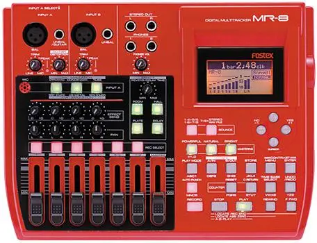

thanks eyes like fire. Do you have the Fostex MR-8 too? What if I want to connect it to the computer for a mixdown? what cable should I get?

thanks eyes like fire. Do you have the Fostex MR-8 too? What if I want to connect it to the computer for a mixdown? what cable should I get?[/url]
Just like Charvster posted,...
You'll need to go from the Fostex's 1/4" outputs to
the soundcards 1/8 stereo mini plug input.

Yes...
Go from the "Stereo Out" of the Foxtex.....
The Stereo out on the Foxtex takes the two 1/4" black and red plugs.
You then hook up the single stereo 1/8" mini plug to the input
of your computers soundcard.
