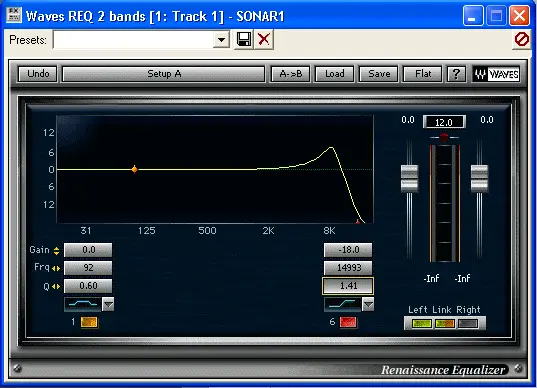

Can you check the Q setting that the Soundforge preset uses? If it's too high, your high-shelf filter will actually introduce a boost at around 8Kz. The image I attached should help visualize it. I suspect that's what's going on, since a boost at 8Khz would definitely make a track sound brighter.
If you want to just trim everything above 15Khz, you should use a low-pass filter.

Scrubs and noissewreck are both basically correct. I have to wonder if this is one of those "when you know everything is right, but the answer still comes out wrong, something you know is right is actually wrong" instances. ;)
If it's not; if we take the case at face value, then I'd have to ask how that could theoretically be and what's causing it. So this is just theoretical specualtion, but perhaps something along the lines of...
A hypersonic noise in the 15-20kHz range is coming from somewhere (electronics RFI? colored microphone? commie satellites?) and being recorded. This noise itself is mostly inaudible, but it has a first-level subharmonic that is phase interfering with some good, bright stuff in the 7.5 - 10kHz range.
You got a spectrum analyzer? If so, what is it showing above 15k before you put up the shelf? Any annoying bumps up there? Or if you don't have an RTA, you could sweep through the uppers with a parametric EQ to see if you can slot out a particular offending frequency.
If you can ID a particular culprit frequency, that might help ID the source. And you really want to ID the source, because shelving all that stuff is normally not a great idea - expecially if you have quality mics and pres that can actually deliver the good "air" that can be found up there.
Just some semi-educated guessing...
EDIT: Just read DM1's post. I'm going with that for now. Nice call, DM1 :).
That explanation actually makes the most sense. I don't have really great gear, just ok, so I'm not sure what I'm getting up that high in terms of ultra sonics and harmonics, but the possibility of an 8K bump coming off the shelf would explain a lot.
