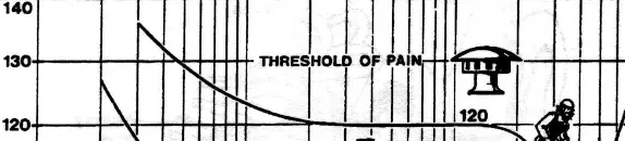

still a bit confused on why they'd use a mushroom smurf house on the threshold of pain spl :D
