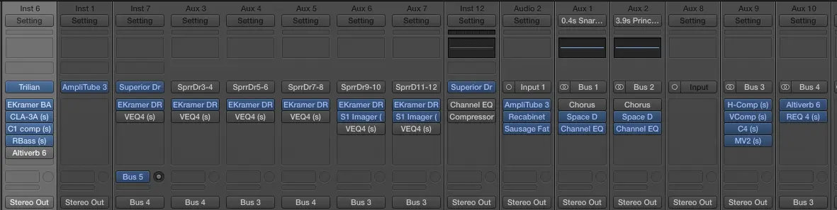

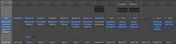

My memory as of the moment has 60.67 GB free out of 499.25 GB. It's smoother now compared to before. Because I deleted around 40 GB worth of memory. Basically, the "system overload" rarely appears now. But I still notice that my Mac is quite slow in responding especially while clicking on plugins while playing my session. Before clearing that 40 GB worth of memory yesterday I got the "system overload" more frequently.
I'm not entirely sure about the CPU usage, but when I play my session, the CPU meter gets to about half of the bar up to 3/4ths of the bar on average.
Here is what's going on my mixer to give you guys an idea https://z-n.ak.fbcdn.net/sphotos-h...._=1416004767_f0412a23c7f1368314dd3b6def13d743

That 60 odd gb isn't memory. It's hard disk storage.
Even when you had 20gb left, that shouldn't be close enough to the edge to slow down your machine, although I'm not going to flat rule it out.
Memory is the 4gb 1333mhz you've got. There's a much greater chance that that's holding you back.
My mac book pro is (was) more or less the same spec as yours. I popped 16gb ram into it and it made a huge difference.
Judging by usage now, 8gb would have been fine, though.
If you continue to get problems, check 'activity monitor' and look for free memory and page outs.
If free memory is low and/or page outs is a big number, you'd want to upgrade your memory. ;)
