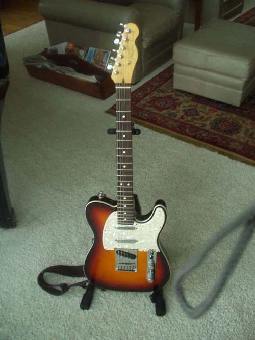

Hello-

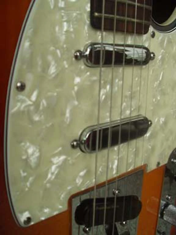

I recently stumbled upon a unique telecaster that I decided to buy. It has some features that are atypical for this guitar, and I was wondering if any of the guitar gurus here might be able to give me some more information about it. First of all, it has 3 pickups: what looks to be a gold lace sensor at the bridge (it says "Fender-Lace Sensor" in gold lettering) and 2 pickups in the middle and neck positions with chrome covers. I was wondering if someone might be able to tell me what kind of pickups are in there.
Secondly, the guitar has a 5-way switch, as well as a tone pot with some kind of detente in the middle that I assume corresponds to a "neutral" frequency response. Is this a TBX tone control circuit? It also has another switch that might be a "phase" control, but the difference it makes in the sound is almost imperceptible.

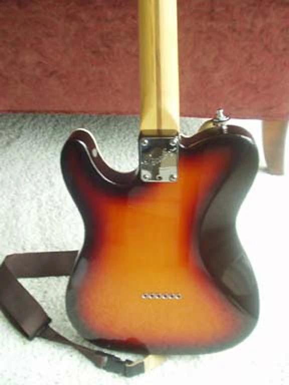

Finally, the back of the guitar is contoured in back and on top (where the guitar might rest against your stomach).
I think this model might be a Plus/Deluxe, but I'm not quite sure. I haven't found any pictures on the internet that look like this guitar, so I'm hoping someone here might have some experience with it.
Thanks for the help!
~Jordan

Looks like you got yourself a Tele Plus.
I just checked the documentation that was with mine when I purchased it in '97 and there is no mention of what specific p/ups are fitted although at the time the lace sensors available for Tele's were listed as Blue or Red for the bridge position and Silver or Blue for the neck position.
The additional switch brings in two additional p/up combinations which normally aren't available.............neck and bridge p/ups and ALL three p/ups...........if you have the 5 way set for either neck p/up OR neck/middle, the other switch will bring in the bridge p/up as well.
They are a great guitar and well worth adding to a collection.

Thanks for the reply! I found out through a similar post at Harmony Central that this guitar is a Deluxe/Plus, and that the pickups are 2 tele gold lace sensors in the bridge and neck positions, and a strat gold lace sensor in the center.

Looking through Fender's Frontline magazine from that period tell me this.........before the Summer '98 issue, these guitars were in a category titled Tele Plus/Deluxe, but the only guitars ever in that category were Tele Plus which had 3 lace sensor p/ups (2 chrome covered and 1 strat style).
The summer '98 issue of Frontline didn't list the Plus BUT instead has the Tele Deluxe which was essentially the same guitar except that it was fitted with Fender's new noiseless p/ups and the visual differences were.........bridge p/up looked similar to the Plus, centre p/up similar to the bridge but with white plastic instead of black and the neck p/up was still chrome.
McPig, you have a Tele Plus.
