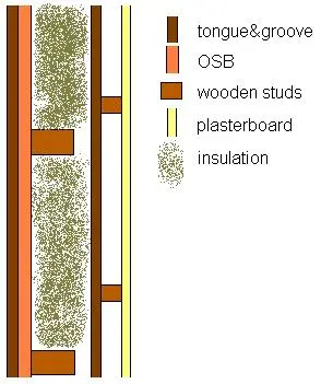

Also, my shed will have three leaves, designed it before i knew, outer is tongue and groove on OBS, decoupled from the inner standard tongue and groove shed with insulation in the void, and then on the studs for the shed will be nailed the plasterboard. Would i be better to try and fill between the tongue and groove shed and plasterboard with sand to add mass, and basically to keep it to 2 leaves?
Draw a plan section detail through the exterior wall showing what you intend to build. Then I'll comment on it. Ok? :)

pandamonk said:
I have everything from this built, apart from the plasterboard. This is not for isolating drums, just for control room, and instruments such as acoustic guitar, vocals etc. And these do not need to be fully isolated, as the neighbours, although close(around 5m away), have an older house with thick(brick i'm guessing) walls and double glazing etc.
Panda,
You're right - it is a 3 leaf system - and it will suffer due to that 3rd leaf - especially with that small cavity you shouw on the inside.
I wouldn't reccomend sand in the cavity - that get's pretty messy and is very difficult to fill the entire cavity with- BUT - you can effectively turn this into a 2 leaf system through the use of expansive foam.
I don't mean the garbage they sell at Home Despot - but rather the medium density products they sell for commercial use.
Here's a link to some Dow Chemical products:
http://www.dow.com/buildingproducts/frothpak/prod_config.htm
The low rise product with the 2.25lb density is a pretty good bet.... (FROTH-PAK 160).
This will provide a pretty effective bond between the innner and outer skins - as well as a complete air passage barrier.......
If you finish the construction of your walls you can install this through a small hole at the top of the 1st layer of inner drywall.
BTW - I would reccomend at least 2 layers of drywall on that innner surface - and you may need even more to gain any real degree of isolation with the lack of mass on the exterior wall assembly.
Sincerely,
Rod

I agree! i'll hopefully have enought funds for something like this. What degree of isolation should i expect doing it the way i am? And how much should i expect with the expansive foam, and 2nd layer of drywall? Also how much would that expansive foam cost if I'm doing a 14x8 shed?

what size is that interior stud frame?

What you mean? I think it's around 2" deep, and its the size of the shed. shed has a 6-7' slanted roof.
