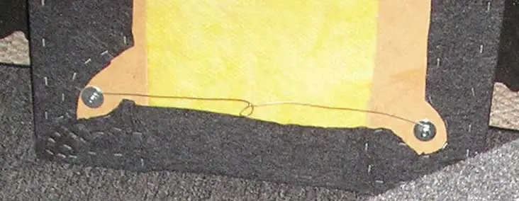

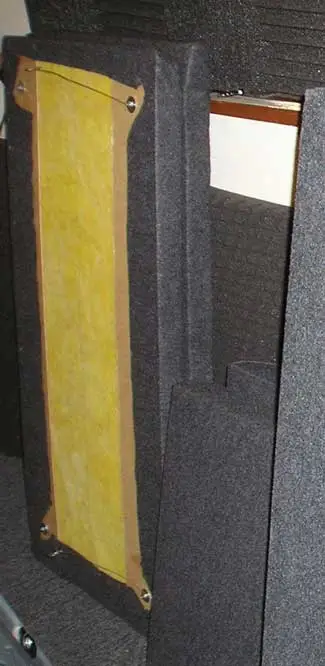

I Made my clouds out of 703. I used 1/4" strips of particle board, 3M spray adhesive and staples.
These are the only pics I have of my clouds before hanging.
They have lag bolts that gop through the 703 and the 1/4" particle board as you can see. The other side of the cloud where the head of the bolt is has some more pieces of that 1/4" particle board as washers. but not too big or they'd cause too much reflection.
Then I tightened the bailing wire around the nuts and put a loop to hang from hooks.

Sorry the images kind of suck, they're all I have ready to show.
second image.
