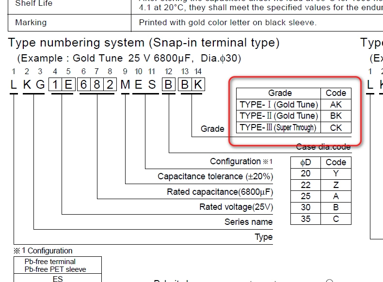

Any chance the caps are Nichicon branded? They evidently grade some of their caps for 'sound quality'.
"TYPE-1: The low profile high tone quality grade of the new development
electrolyte adoption.
TYPE-2: The center grade that the best sound is provided electrode foil,
with the multiple use.
TYPE-3: The highest tone quality grade by the low drag the gold plating
terminal adoption."
The AK, BK, and CK are the type designations.
https://www.nichicon.co.jp/english/products/pdfs/e-lkg.pdf
I have come across Nichicon caps occasionally, but don't recall if there was any letter suffix and likely any good quality cap with the same uf and voltage rating would work fine.

You are way overthinking this. Miroslav only shared the link to answer the question what does “B.K.” mean. You do not need that specific brand of cap. Just get Nichicon PW series caps...readily available, and affordable...likely spec better than the BK caps...and be done with it.
