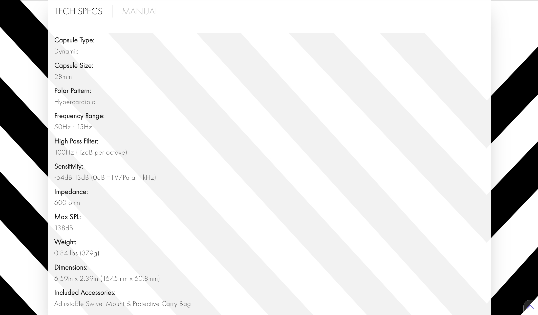

I don't know anything about microphones beyond "just get an SM58, it'll do anything." But I have some extra cash to spend and want to upgrade. I'll mostly be talking into it but I'll likely sing into it as well. This is what I'm looking at.
Limelight Dynamic

It's made to look like a Electro-Voice RE20/RE320/RE27 broadcast style mic, but I doubt it has the same Variable D feature that minimizes proximity effect. I'd rather get something from a well established brand than something made as a lookalike. If you already have an SM58, why not branch out and get a large diaphragm condenser? You could afford an AKG P240, or get a P220 plus a pop filter.

It appears that 512 audio is the "podcast/streaming" division of Warm Audio. A quick look at the their products shows 2 XLR mics, 2 USB mics and an audio interface. Comparable products would be the Rode Procaster, Shure M7XT and the EV RE320, which is strongly resembles. I've never heard one. One thing I noticed is that they mention that it's tuned for "voice". I can't find any info on the frequency response so I would take that with a grain of salt. Sounds like marketing speak to me.
