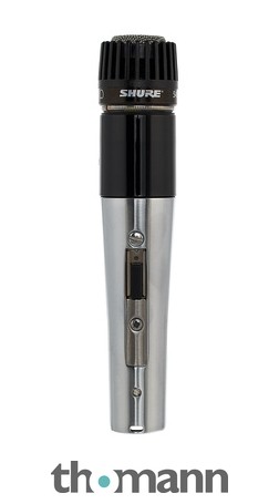

While I wouldn't want to do this for anything as a final product, if you are just recording for idea, you can use something like a Shure 545D in hi impedance mode, and plug that directly into a pedal. Output is around 17mV in the hi Z setting, which is similar to a guitar output. Plus you have the advantage of flipping the internal cable connection to a lo Z setting and having a very similar mic to an SM57, in case you use an more conventional mixer/interface setup.

You would need a powered one, because the regular FEThead (and Cloudlifter) is powered by the 48V phantom power supply, which, or course, your guitar rig does not supply. It will still be a low impedance signal, just louder. The SM57 (and the 545SD) have about 1.7mV output with low impedance (around 200 Ohms), A guitar pickup is a hi impedance device (typically 7-12kOhms), and it's an unbalanced signal (the ground and shield are combined). In Hi Z mode, the 545SD is 17mV, so significantly stronger.
