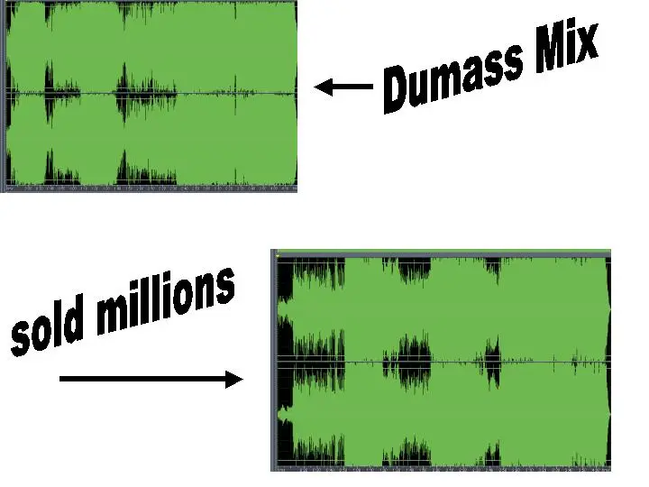

That doesn't necessary mean it clipped... it means it was severely limited and is hitting 0. With the overcompression he did, I would expect to see a squared-off waveform because he squashed it to 0.
But that's NOT clipping. If he didn't have the limiting on, then it could have been squared off due to digital clipping, but then you'd also hear a lot of hash/distortion, which this clip doesn't have....
You have to understand what meters are telling you... the red means it "hit zero", whether it clipped or not is another story altogether -- just hitting zero by itself doesn't mean it actually clipped.

Yeah...and Joro, CEP has a "idiot proof" meter system anyway...I think it's set about -.3db below actual zero...that's what I was talking about when I said "digital overs."
Anyway, while BlueBear usually has all the tact of a nuclear warhead, he's right about the lack of punch...I interpreted it as a lack of Bass Guitar. I could be talking out of my ass, but I'm discovering that if you KNOW you're gonna' squash a mix, it helps to turn up the bass some in the mix...the limiting flattens it out some, at least on my "rock" mixes, lol.
Here's an A/B of your mix and a commercial cut that was in the Top 10 for 6 weeks 2 years ago. Purists would go nuts....I don't really care how a mix looks anymore. :D
