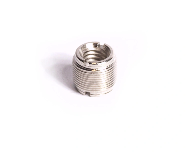

This is what you need: SK-SKSE127.webp

Yeah, I don't think I've seen any/many adapters with the smaller female.
More often than not there's an adapter stuck in there, Yoni.
If you see two slots inside the 57 clip, like on the adapter gecko pictured, then that IS an adapter and you can remove it with a large flat screwdriver.
And..... whichever way you put them in, they come apart with the NON slotted end protruding. Why they don't slot both ends I'll never know.
Don't forget that there are also a few that have different threads each side of the adaptor, often down to ¼" for video tripods and the like. I also have one mic clip that has been made with metric threads which don't fit anything!

That thing sticking out of the bottom of the sm58 Mic clip is the adapter. Take it out of that clip and put it in the octava clip. It just unscrews.
Yup - Looks like a flanged one instead of a slotted one, so you might need pliers or some gripping tool.
Turn it anticlockwise to withdraw it.
