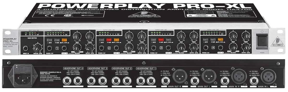

The Behringer HPA4700 has the things you need. Inputs and outputs are either XLR or TRS. You can go from soundcard to HPA4700 with stereo RCA to TRS (or XLR), then to monitors vith TRS or XLR. It has a variety of controls for four head channels, but each channel has an additional two headphone outputs at the back, so you could feed 12 sets of headphones.
>>>THIS<<< was suggested at the "other" forum and the OP appears to be leaning in this direction.

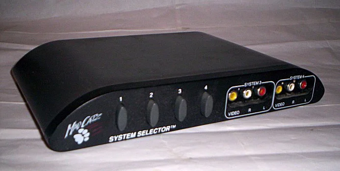

You guys can laugh, but I use the device below for switching the unbalanced stereo line outs of my PC to powered computer monitors, as well as other devices. Cheap and it does what I need adequately :)
HA 4700 is cheap and loud, but my experience with it was that it was very noisy and 'thin' sounding. I upgraded to a Samson S-Phone that just sounded much clearer. It died on me not 30 minutes ago. Is that irony?
