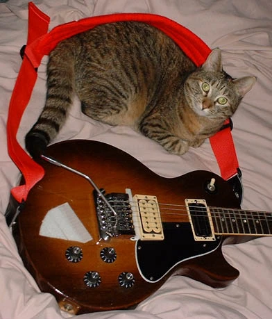

I have an old Kahler and a locking nut on a 1980s LP special (reissue of a 1950s model) - bought it that way. It hooks over the tailpiece studs and requires a big hole routed into the top of the guitar. It is very sensitive and since I'm not a heavy wammy player it is mostly a pain. I will probably convert it back at some point.

Here is what a kahlerized and otherwise hacked LP looks like:
