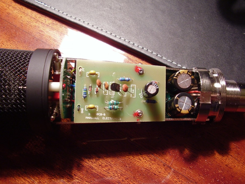

So I will show you how they do. First, if your interface really isn't up to snuff phantom power-wise, it means even lower voltage to the mic. How does the mic handle that? A good step-up circuit will be able to compensate to some degree. A simpler one, say a basic doubler, will cause the capsule polarization voltage to drop. At a minimum, that's a loss of sensitivity and poorer signal-to-noise. So my first question about the guts (this is true for any bit of kit) is how robust is the power supply?
Back to sensitivity--what's the beef there? OK, as I said, the MXL spends 317mW to generate a rather low sensitivity of -43dBV/Pa. Why does that matter, gain is cheap right? Yes, but noise is always waiting to bite you in the butt. -43dBV/Pa combined with 11dBA yields a noise floor at -126dBV-A (-124dBu-A). If you want to avoid accumulating noise along your chain, you need to make sure that your preamp noise is sufficiently quieter than that. Many are, but some aren't. Further, let's talk about noise spectrum as Mr. Joly mentioned. LDCs tend to be very 1/f (pink); preamps are white. So even if your preamp measures -127dBu-A, above 10kHz it will be the dominant noise source. You might never notice if all you record is vocals, but try it on something truly quiet and you might wonder why 11dBA is so noisy . . . you never had that problem with any of your other condenser mics?
Back to our cheap interface problem, those are often not the quietest. So we have a potential system where lack of proper phantom power and a kinda noisy preamp could result in a combo that significantly degrades the noise performance of the system, and when you're done you're back at the effective noise level of the old 2003 mic (16dBA) or worse, but you're using more than twice the power, and you have to use at least 7dB more gain to hit the same level.
