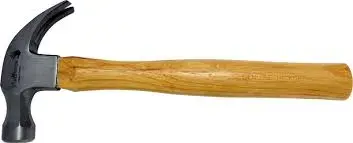

Try some fine adjusting it with this and see if it still works:
We are traveling around in a trailer right now... Our awning was stuck and I used that tool for some fine adjustment..... The new awning is on order.......
