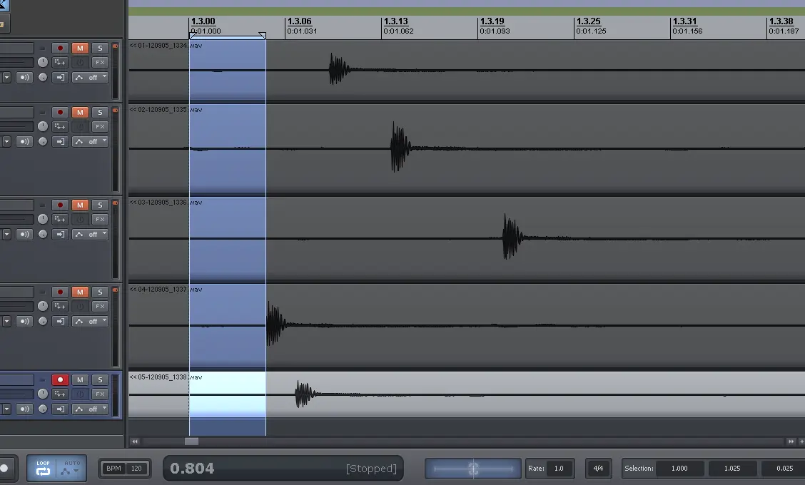

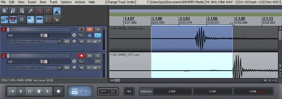

i record Reaper's metronome with a microphone with about 4 centimeters of distance to the speaker.
What happens:
Well even on the first run you can see, there is a gap of 25ms, but it gets worse: after the first run i put an effect on the first track an muted the track and then recorded the second run on a new track.
i also did this WITHOUT putting an effect and there the timing stayed on 25ms for the next run.
Again:
i will now save the project, restart Reaper and do the same test (WITHOUT putting FX) again:
1st run: 45ms
2nd run: 66ms
3rd run: 104ms
now i "reset" the audio-device by going to the Audio->Device Pref.Page
4th run: 25ms
5th run: 37ms
between runs 1 to 3 i switched windows to firefox.
between 4 and 5 i did not and the mis-timing increased anyway.
This is how it looks:

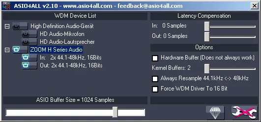

Settings:

* Experimenting with the ASIO4All Driver with lots of different settings.
* Trying out older ASIO4All version. Down to 2.8...
