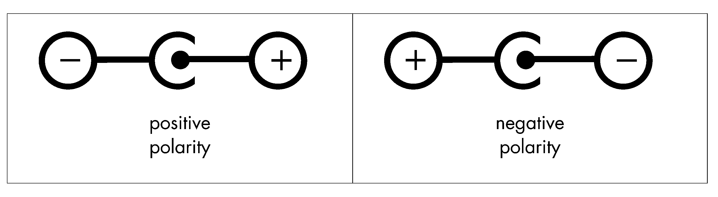

You don't have to play russion roulette with the power supply. As others have said, the amperage doesn't matter much, as long as it will supply enough. Of course, it must match your ART, either AC or DC. For the polarity, it should be printed on both the adapter and the device near the plug.
Just make sure they are the same.
