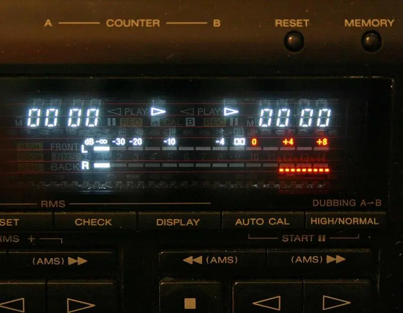

Its subjective. Baseline for me would be the 0VU segment being hit regularly, +2 (not labelled) once in a while, and +4 hardly ever, assuming no noise reduction switched in. Then adjust to taste. If you are using tape as an effect then some like to hit it considerably hotter, if you are using it as a recording medium start out as above.
*edit, if you are asking about levels during playback? They could be all over the place depending on who what where and with what the recordings were made.
On a good quality tape, have 0 hit most of the time, +2 a fair bit, and the loudest peaks (occasional) +4. Poor quality tape won't handle this but don't use poor quality tape anyway.
Purely by memory from a long time ago: Peak at +3dB from the Dolby mark, add another 3dB if you've got HXPro on. It looks like the Dolby 0 mark is at -2dB on that scale, so peak at +4 by that meter when using HXPro.
It also depends on the tape type - I used to rather like Chrome Dioxide which I pushed quite a bit. Ferric tapes were prone to saturate if you pushed them, but in those days you just did a test and worked it out for yourself, based on what sounded best.
Sorry, I'm mastering on the Tascam then mixing it out to the Sony, so I'm watching the Sony levels. I use Type II cassette tape on the Tascam - at high speed - then Type I tape on the Sony at normal speed.
Actually, you're mixing on the Tascam and (more or less) mastering on the Sony.
Why use Type I tape at all? Type II is better all around. I'd use that or Type IV in the mixdown deck. Type I is what we used to use for spoken word and other stuff where quality wasn't as important.
