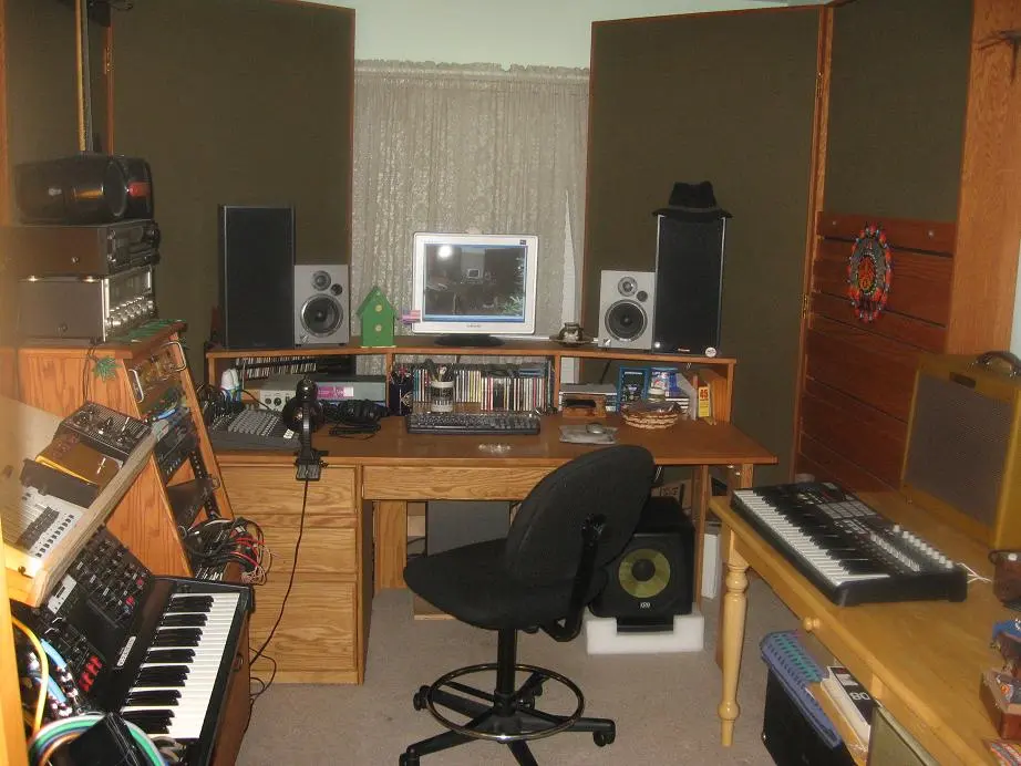

I wound up doing months of research and building 14-lineal-feet of gobos 7'6" tall based on John Sayer's designs.
Now those are some serious gobos in your picture!![]()
Spent about 4 months building those in the living room. The original idea was to use them kinda like a vocal booth. The backs are 1/4" oak-faced ply ripped down the middle with a router at a 6-1/2-degree angle. Not a single nail in the entire setup. The backs are glued onto angled pinewood frames wrapped with 3/4" oak ply. Stuffed with 3-1/2 inches of Knauf Soundboard. About $350 worth IIRC! The one with the slot resonator is 5 inches deep. The resonator is tuned to 250Hz as the center band, and an octave each side of that. Everything covered with hemp cloth, of course!
I built the rack on the LHS of the pic too. It's 24" deep and 48" high. 14-space rails over a 12" deep drawer. Built with Kreg joinery techniques. Wish I had built two. The rack was quick, only took a week to put together in the living room. Damn I miss having a garage!
The desk started out as a corner unit. I built a top for it out of about 3/4 of a sheet of birch ply. It's 6'6" wide and 42" deep.
