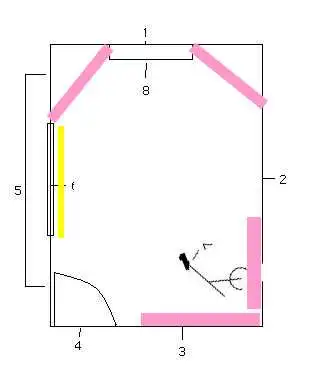

hey all.
im looking for a bit of advice on the treatment of my vocal booth, it is a new construction whichy is finished except for the wall coverings (t&g/cloth), the walls heve 6" green non compressed rockwool at the moment and i am wondering how much of the walls i should leave cloth and how i should go about absorbing the lower frequencies.
1. external wall with 6" green non compressed rockwool .6' wide
2. external wall with 6" green non compressed rockwool. 10' 6" long
3. internal 4"stud with 4" green non compressed rockwool, wiuld prefer to drywall and then t&g this wall for isolation
4. standard 2' 8" door
5. internal 4" stud with 6"wall behind (soundproof) 6" green non compressed rockwool on interior
6. 4' *4' window
7. mic position
8. amp cab position
comments and suggestions would be greatly appreciated
booth plan

here's some help
sorry guys didnt realize that, but the photos there now, thanks orksnork. il post up some photos of the studio when i get a chance.

Correct, rock wool and fiberglass are equivalent accoustically. The important thing is the density. You want between 3 and 5 pounds per cubic foot.
Put heavy drapes in front of the window and speak toward a corner of absorbers with bass traps on opposite corners.
the purpose of the window is to be able to see into the booth from the control room so i would prefer not to have it covered and to heve the vocalist visible through the window
if the vocalist is singing into traps in the corner that should help alleviate a lot of room reflections...
make sure you glass is angled.
its a double window with the vocal booth side angled, well ya singing into the corner would be the easiest solution but bear in mind this is in the process of being built from scratch and almost anything is possible.
